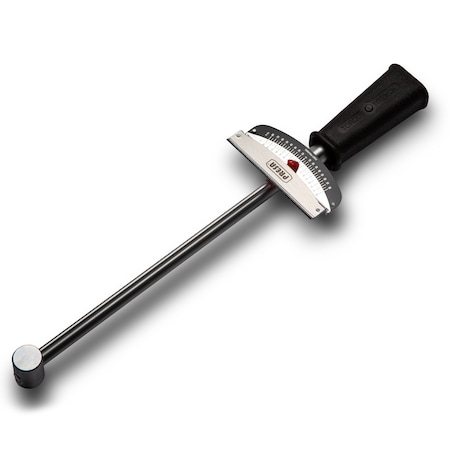

For torque wrench, the most economical and durable is a beam type. Lasts forever, forgiving of abuse and much cheaper than the fancy split beam, or the digital "clicker" types which require care and need to be re-calibrated periodically to prevent risk of causing trouble. When those type need recalibrating a beam type is used to do it. The tradeoff of a beam type is they are less convenient (requires line of sight to the scale).
