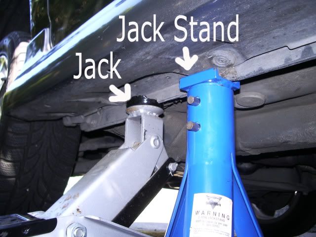

With your car on hard level ground, e-brake set and car in 1st gear or park, jack the front up; I used the drivers side jack insert just aft of the front tire, and support the jack with a jack stand right next to it. Give the tire (in the air) a good shove to make sure the car is sturdy on the stand (so the car doesn't fall on you while your working underneath).
Pic of my jack and jack stand set up.

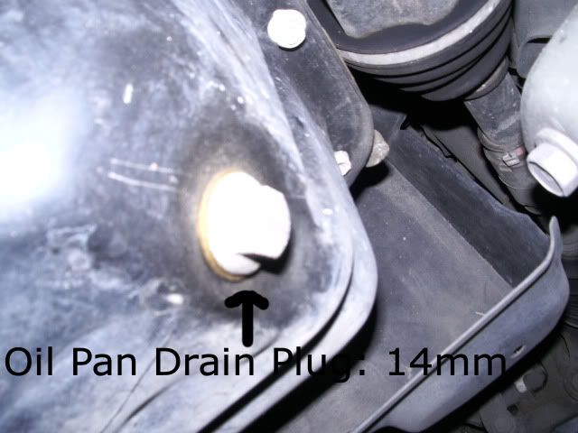

Next we should find the oil pan drain plug. The oil pan drain plug can be found underneath cars near the bottom of the engine on the oil pan. On the ZZ engines the oil pan drain plug is near the bottom towards rear of the engine oil pan pointing towards the rear of the car. On the 2ZZ-GE it will take a 14mm socket/ratchet or 14mm wrench.
Pic of the oil pan drain plug on the 2ZZ-GE on the back of the oil pan, it takes a 14mm socket/ratchet or 14mm wrench.
Note: Be CAREFUL!!! Engines can be very hot and you may be susceptible to burns by the engine or the engine oil, especially if you have just driven the car. Thanks to tigerclaws1318 and tarbasd for the reminder!
