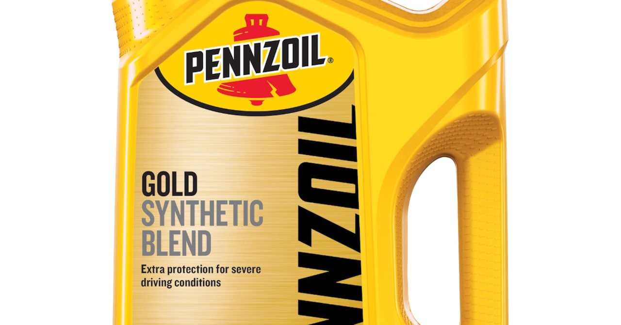

There is Pennzoil Gold Synthetic Blend 0w20, which is SN-Plus.
There doesn't seem to be a VOA online, that will tell you how much detergents are in it with the Total Base Number (and the ratio between Calcium Sulfonate to Magnesium Sulfonate) and other additives in it, like Molybdendum, etc.
