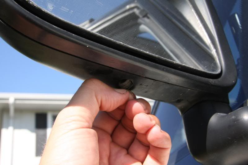

The last two Previas that I purchased had mirrors that were calked in place because the wiggled and were loose . So, I thought I would post a thread on how to fix it.
Under the mirror housing is a rubber plug. Remove the plug. In the hole, you will find a phillips head. Thighten it. Just snug. the other side is plastic and will break if tightened to tight... SO, JUST SNUG.... then replace plug... you are finished>>>>
Beware, I found this fix ages ago and it was probably just before 200K miles. The plastic was so brittle that it did break. It broke before I actually got it tight enough to stop the wobble. The reason...is the design of the tension screw. On it's end it has an 1/8" section that is unthreaded. This section acts as a bullet that impacts the bottom (top) of the bore to cause friction and tension so as to quite the wobble. In reality it's bullet shape causes it to act as an impact hammer of sorts and the end result is breaking the plastic housing. The avoidance fix for this is to remove the screw and mirror from the housing. Spread some JB Weld (or another quality epoxy) in a strategic manner so as to reinforce the brittle housing. When you are satisfied with your epoxy work and are ready to put it back together then use a light (pipe tape) friction material on the threads of the screw to inhibit any excess vibration without having to tighten the screw to the point of compromising the housing. Trust me...proceed with caution. Once you break this if you are not good with rigging a fix the mirror is very expensive.
Fixed!
Thanks guys. I thought I was going to have a big job, deconstructing the door panel..etc.., but following your advice I was able to fix both of my mirrors in about 45 seconds with just a careful tweak of a phillips screwdriver. Thanks for sharing and saving the day for me!

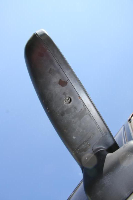

unscrew the phillips screw and it should pop out from the bottom ...

The screw is its 3'rd hold down point. If you tighten it and it solves your issue , it will come back because there are only 2 points on the mirror that are holding it instead of the 3 that were designed. I Would like to see a picture of these RTV and GLUE DOWN fixes !? They seem a little on the way to permanent for my taste, but that's just me. If it works for you that's cool but if you want to fix it somewhat the way it was designed to work , take a look at my fix. It may just work out better for you I DON'T KNOW !?
