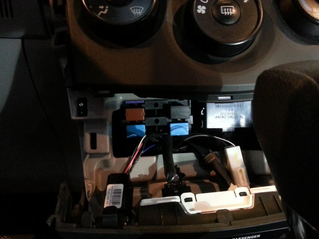

I've searched for hours...
and at best came up with a couple blurry nondescript pictures...
and written comments that seem to be lacking in detail.
I was hoping to get a clear picture of the correct fuse/relay panel,
that holds this fog relay, prior to my tearing the dash apart.
Helps to see what I'm looking for, prior to searching for it.
Might any one have a decent picture/diagram
that shows the position of where the fog relay inserts ?
thanks ahead if you can help.
ps: I realize it is located somewhere behind he heater control unit.
2nd from top on right hand side.
this the relay placement location on the block ?
if yes...
fairly obvious as to how the relay inserts ?
~ I'll be bummed if I get it all apart...
and there's already a relay in there
~ :facepalm:
I already knew where the relay block was located...
and getting to it doesn't intimidate me much either.
Just wasn't sure what the relay block/layout looked like...
so a decent picture or diagram was what I hoped for.
^ that way muh brain can rub two cells together and maybe find spark. Lol
thanks for your response

#7 · (Edited)
perfect... exactly what I was hoping for...
couldn't find a picture for the life of me.
thank you very much for posting those :thumbsup:
I'll post up the relay location/block diagrams
just in case the link posted by "stvotw" fails...
#8 · (Edited)
the previous pictures do not depict what I have.
but then... my le was assembled in japan
here's a picture showing the relay block in my 2010 le
my le is pre-wired for fogs and even has a fog L fuse in the fuse panel
I haven't test the circuit for current yet...
the two terminals below it don't have contacts in them that I see.
to test the circuit for power...
which two pin inputs on the terminal are the pos/neg ? ( 1 n 2 ? )
I've come to realize there are at least two different relay block designs...
there could be more and I'm just unaware.
I have concluded I have relay block # 6
the different relay blocks utilized...
is likely dependent on where the vehicle was assembled
and what was sourced locally there.
