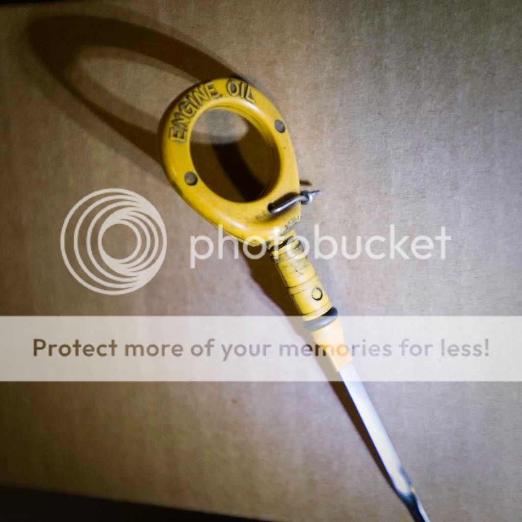

OK here's the scoop. The dipstick is 17.75" long from the bottom of the pull ring to the tip of the dip (the length that is inserted into the tube). There is no part number, just the words "engine oil" on the yellow handle.
I'm still bothered that I have just the tinniest tip of the dipstick reaching the oil after putting in 5.5 qt. and a new filter. :eek: (this is warmed up, of course)
Here's a picture of the stick... is this stock? Can someone measure the length of your dipstick?
Thanks again for the help Bam!
Doing a quick measurement...my dipstick is 20 7/8" long. The dipstick yer showing doesn't even look close to the stock one. :(
Dipstick handle should be a D shape
The number on my dipstick is 62060.
ToyoDIY confirms the number on the stick with the stock number. Part number 15301-62060
From ToyotaPartSales.com
Item Number MSRP Core Price Price
1530162060 $14.15 $0.00 $11.06
Engine - Engine parts - Dipstick
Dipstick - 3.4 liter 1995 - 1998
WoW! This is what I suspected. When I bought the truck I checked the dipstick and the oil level appeared proper. I bet the fool was totally overfilling it all the time. :lol: Now I'm not surprised I have leaking gaskets! :thumbsdow
