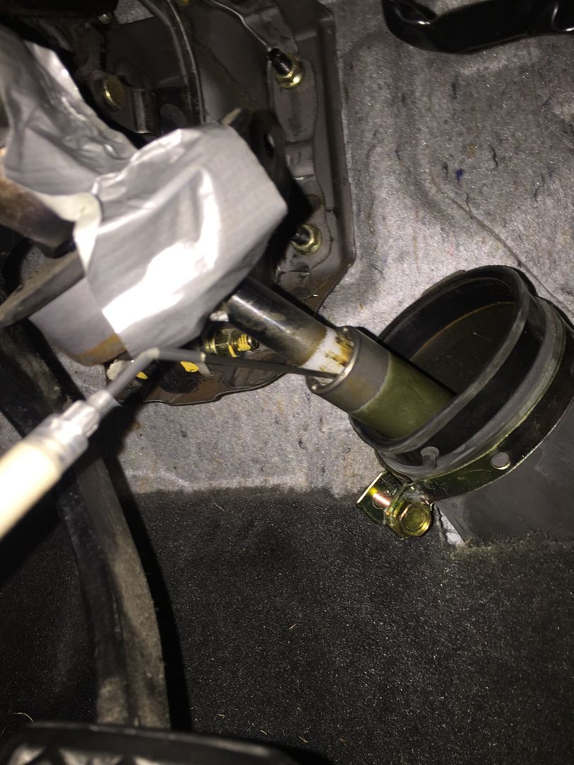

#14 · (Edited)
The intermediate shaft will not always clunk.... the shaft has two functions, to allow the shaft to slide in and out and it has a U joint to allow it to turn. When the shaft doesn't slide well, and this is a known issue, it clunks. A good cleaning and greasing will typically fix this. The sliding is so that it forgives any body flex and also keeps you from getting harpooned by the column is case of an accident. When you get stiff spots, it's the needle bearings in the U joint binding up.
I had this happen to my '06 Tacoma and this is nothing to ignore, you are literally close to locking up and smashing into something. There are reported cases to the NTSB about these unprotected u joints locking up and failing. I don't know why Toyota doesn't protect these from the elements like the US manufacturers do.
If it is in fact the u joint failing, don't waste your time spraying it with PB Blaster and caliling it fixed. Yes do it to confirm that this is the issue, then get it fixed right away. One you are to the point where the needle bearings are locking up, the damage is already done, grease or penetrant is not the answer.
These can be changed as a DIY project, just be sure to line everything rotationally the same way the old one came off so that everything is still in sync or in phase.
Reactions: longrange1998

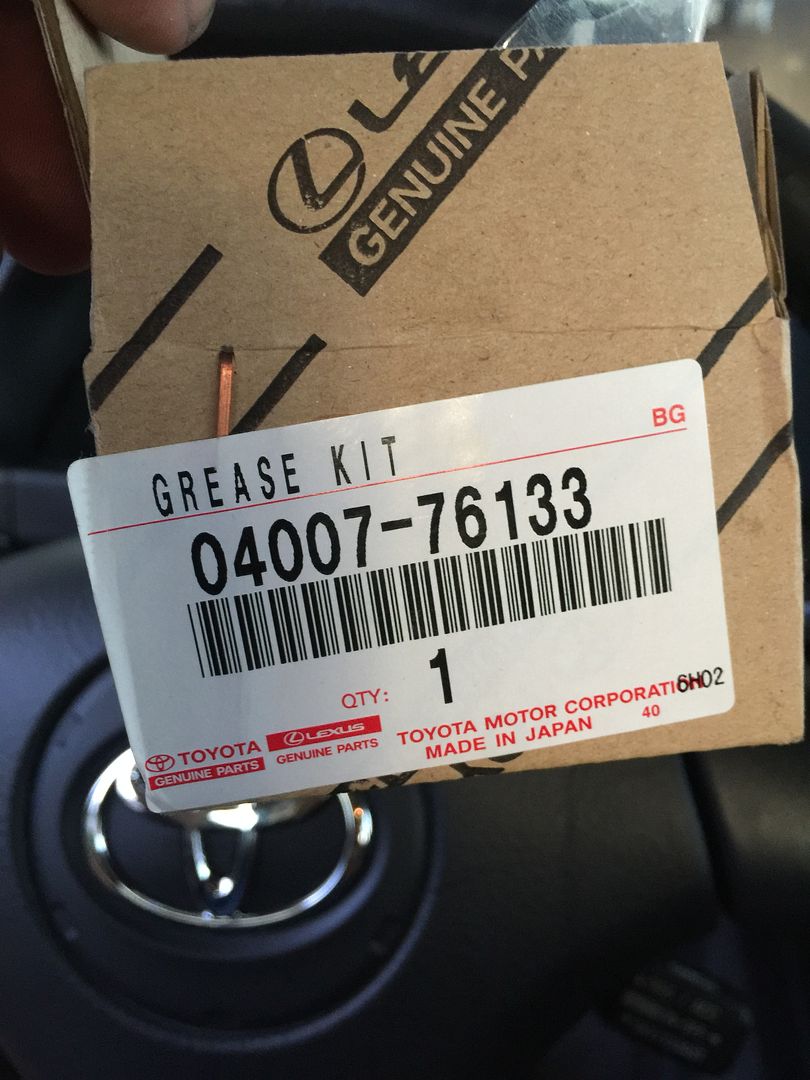

Crooked dealer wants to replace a shaft that simply needs greasing. Honest bunch over there, eh?
There is a TSB and grease kits for the shaft. Either DIY or buy the grease kit and have any mechanic follow the TSB.
