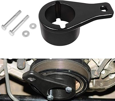

To tighten the bolt you must hold the crank from turning. The simplest way to do this is using your old, scrap timing belt. Wrap it around the pulley and grip it with a vice grip so it is tight and hold the vise grip while applying the torque wrench to the bolt.
Toyota's special service tool is just a ring with holes you can bolt to the front of the pulley, using the same threaded holes you would use to pull the pulley off it if was stuck on the crank, and the ring has a bar welded on that you hold as a lever arm while applying the tightening torque to the bolt. If you are handy you could make one. If not, you can use the old belt as described.

-- Using other reports on the net, I experimented with a 2x4 for tightening down the bolt. I drilled holes appropriately. I used higher strength bolts for fastening the 2x4 to the pulley. The 2x4 was iffy. I broke one 2x4 at one point. I quickly abandoned the 2x4 idea. It's not worth the "iffiness." Maybe the 80 ft-lbs of torque is pushing it for the stress limit of 2x4, unless maybe one uses pressure treated 2x4? Dunno. I eventually built my own pulley holder tool from steel scrap parts I had laying around. From experience, use at least metric Class 10.9 bolts. Sometimes even those bend when freeing the HB. If the DIY tool is going to be used a lot, Class 12.9 is likely the best choice.
-- The video Techsus linked has an excellent example of a DIY pulley holder tool, starting at about 15:00. (Remember that the harmonic balancer and its bolt are the same on the 3SFE engine and the OP's 5SFE engine.)

B. weighted socket (these add considerable torque)
C. Harmonic balancer removal tool to hold the pulley in place/stop the engine from turning when cranking on the bolt.
The bolt came off like butter on the first trigger pull.
