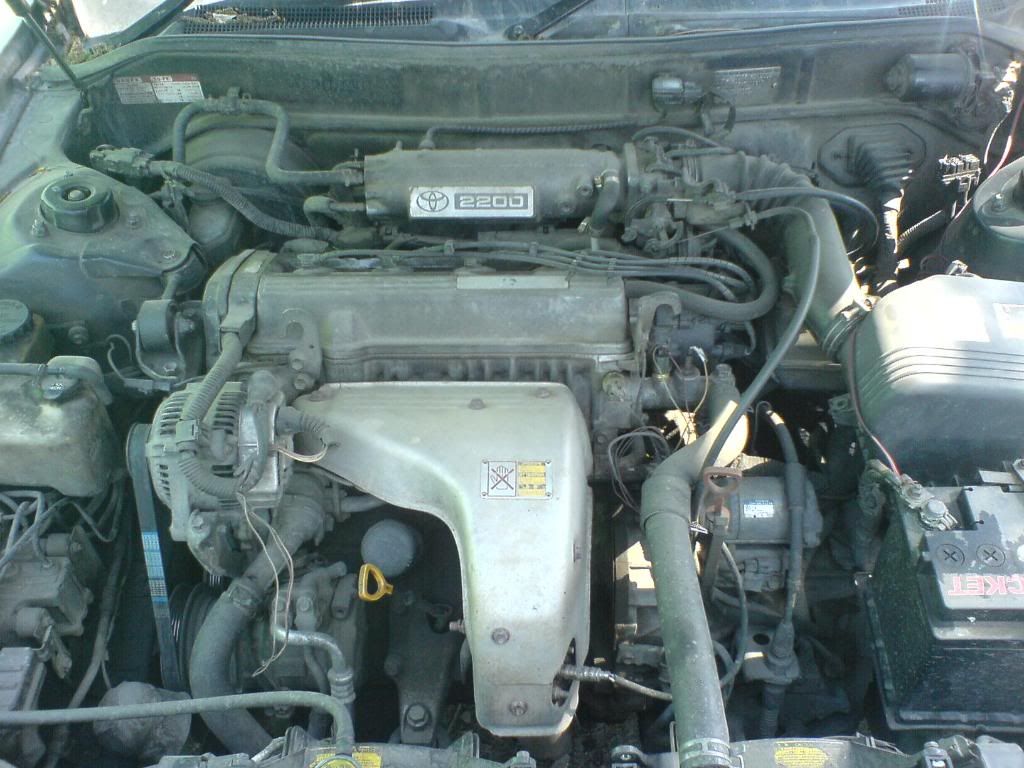

Good time, I write through the translator of Google, do not swear much in the wrong translation,for 2 years a cat in a car, fuel consumption per 100 km -15 liters of gasoline has replaced the entire fuel line and fuel pump, cleaned the engine nozzle, and the mood lighting, during the movement of gas trying to pressure not higher than 2500-3000 rpm, even when pressed the brake and drive motor turned very shakes and turns with about 600-650, and 650-700 when the parking lot of turns, how to adjust the engine speed?, turnovers, I read with a computer through the OBD diagnostic connector

I do see the O2 sensor on the manifold, and the water temp sensors.
The next culprit is the thermostat or the water temperature sensor that is actually making the engine cold , or telling the engine computer that it is cold and to use more gasoline.

I changed the thermostat to the new and changed water pump, oxygen sensor, I also changed about a year ago, also changed the temperature sensor for the computer, and I do not have a catalyst, I knocked him because he was all dirty after a poor filling of gasoline, I'll be photo give
