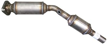

PS.....it may be your converter pipe bad also. Those are expensive, check with the dealer. I got mine on Amazon.ca for cheap. Works fine..

I crawled under the car while it was on ramps in my driveway. The converter and piping was rusty, but I didn’t see or hear any holes. When I was under the hood feeling in behind where the exhaust manifold meets the pipe at the doughnut gasket, I could smell strong exhaust. I’m pretty sure it’s the manifold. I still have my truck insured so I can drive that too and from work for now. The oem exhaust manifold is $285 from Toyota parts direct Canada. I’d go that route over the dorman
