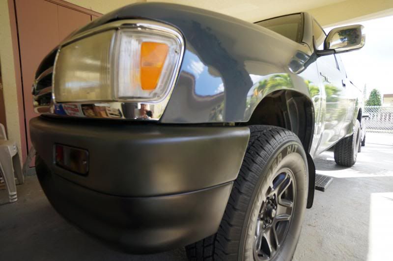

I have shared a couple pics on the picture thread but I'll attach the pic of the truck here too... if you guys want me to take pictures under the truck I can do that if it can help with my issue.
