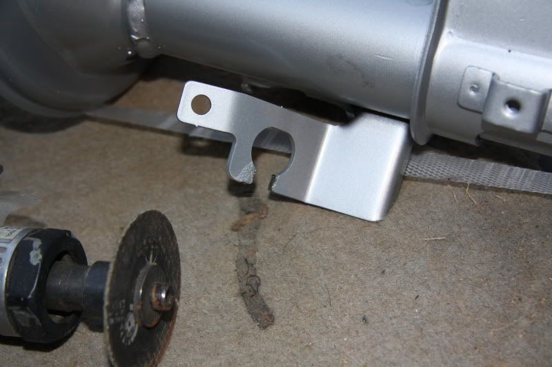

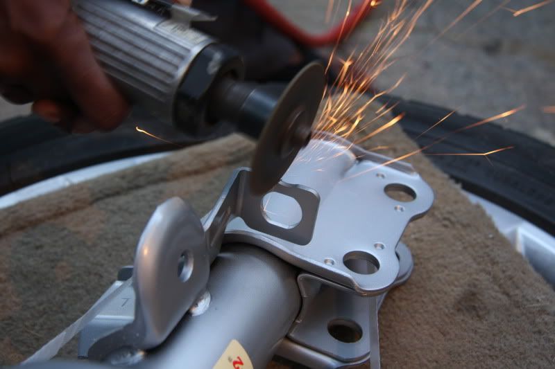

I just replaced my shocks on all 4 wheels. Here is a little trick that saved me a lot of time and even money ( concidering last time I replaced Shocks, I had to buy new brake lines cause I stripped out the old ones due to rust)

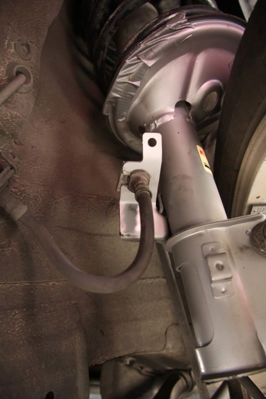

Simply cut a small gap to the hole where the brake line is suposed to go into, and slide the already attached line through it. I used the cut off saw for the new shocks, you can use a good set of wire snips for the ones that are already on the vehicle.... ( pardon the tape in the last pic. i was having trouble with my spring compress and i needed to tape the rubber down in place...):clap:
This is done for both mounts and keeps you from having to separate your brake line....

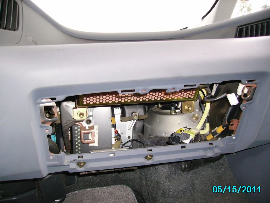

Any tips to removing the front struts & getting to the upper strut bolts to get this out? Doesn't look as straight forward as on any of my cars! Also do the strut tops need to be replaced or have others just reused the OEM ones?
regarding the "trick" above, I did something similar too, but I didn't actually cut out an entire section. I just cut a slit, and then bent the sheet metal to get the brake lines in and then bent it back into place. I preferred this way so there's more metal holding the brake line in place and there's no way it can accidentally "pop" off.
on the other hand, take a look at your brake lines... these vans are old enough that the rubber lining is likely to be cracked and those brake lines need replacing anyway.
as for tips to remove the 3 nuts on the strut mounts, it helps to have a low profile ratchet or an offset wrench to break the nut loose. once it's loose, i find it faster to get in there with a stubby ratchet or a socket with a knurl so i can just spin it by finger tips. support the entire strut assembly from below with a floor jack or something so it doesn't fall out/down as that makes removing the nuts more difficult. I normally loosen the two bolts that hold the steering knuckle to the struts, but keep the bolts in place, remove the 3 nuts on the strut mount, then get out of the car and hold the strut/springs with one hand and lower the entire assembly. once it's lowered enough to clear the wheel well, pivot outward and fully remove the 2 bolts. it's a good idea to have someone hold the steering knuckle and/or brake rotor assembly as it is only connected by the ball joint at this point and will just flop over and hit the floor. tie it up to something so that doesn't happen.
something to keep in mind, i experienced this myself and I've seen others report similarly. when you replace the struts, some cars seem to develop positive camber that cannot be adjusted unless you install an eccentric bolt. after putting everything together and letting the suspension settle, do a quick eye-ball check on your camber. if you think you have positive camber, order the eccentric bolts. driving around with positive camber has all sorts of strange 'effects' beyond just wearing the tires down in a bad way; like at 80% lock the wheel will want to turn itself to 100% lock.
