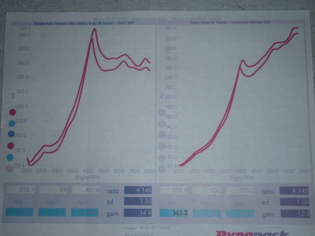

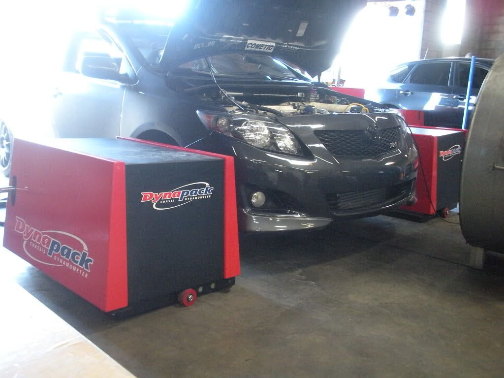

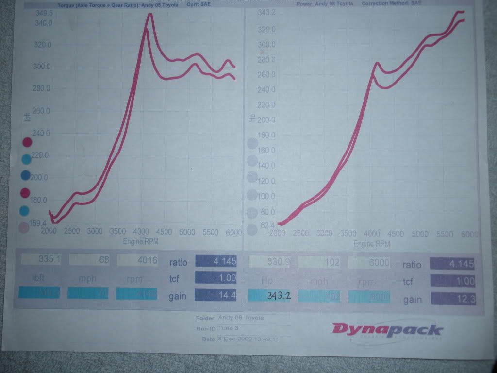

haha finally got my car dyno tune and i was really happy with my numbers made 343.2 hp and 349.5lbft of torque!! yeah i know people gonna say why on a toyota dis and that but i dont care is my car and yes im faster than you!!:lol:
here is the dyno they where running out of ink but you could tell.
mods are custom turbo kit with a gt28 turbo port and polish head racing clutch and fly wheel 550cc injectors with a walbro 255 fuel pump cp pistons 9.0.compression with a cometic head gasket and only 13lb of boost my motor could handle alot more.

not bad numbers at all for the 2AZ...hope it stays reliable for ya.

i bet you could push it past 500 pretty easy without risking damage to engine. with the engine work and low amount of boost your running right now i'm pretty sure that engine will be as reliable as a NA. got coils on it yet?
