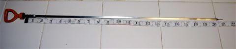

I have 1995 T100 3.4l . The dipstick that came with the truck doesnt read in operating range until I add 7 + quarts of oil. I've searched and even had the dealer check my vin to see if maybe their was an optional 7 quart pan, he couldnt find any. I know 5.5 qt is standard but it doesnt even register on the dipstick. Would soeone PLEASE help me out. If you have a 3.4 L T100 please tell me the length of your dipstick. Daughter moving up north on Suunday and i really need to find out. Thanks

I've had my 95' since new so I know it's correct, hope this helps!
From base of handle to tip 21 1/8"
Also there is the number 62060 pressed into the flat area just above the pattern embossed on the end of it. Number appears just above the"F" mark.
#62060 are the last 5 digits of the dipsticks P/N of 1530162060
GAGE SUB-ASSY, OIL LEVEL.
This genuine part fits your 1995 TOYOTA T100 DELUXE 3400CC EFI, MANUAL ,5-SPEED.
Stock Code 1530162060
Manufacturer Toyota
