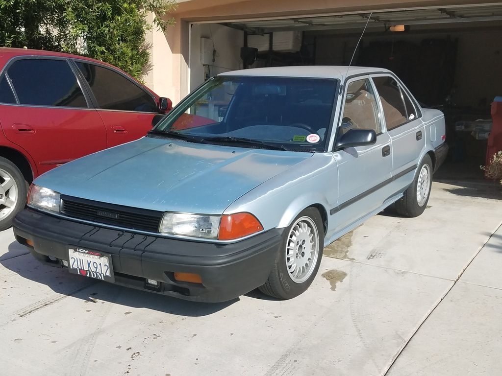

i picked up a set of bmw E30 bottle caps, they look right at home on my 4 door, just bolted right on without any issues, same offset as our factory wheels if i'm not mistaken
