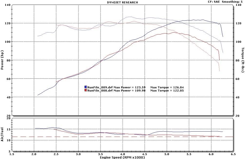

Dyno comparison between 2 5s-fe 5 speed Celicas
Credit for the dyno chart goes to presure2 on Celicatech
Link to the thread on Celicatech: LINK
Red line is stock with an intake
Blue line is aftermarket cams, exhaust, and intake
