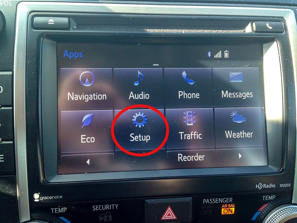

Here is how to get to the calibration routine ... at least on my 2014.5 TCH SE
First select the physical "APPS" button ... then select "SETUP"

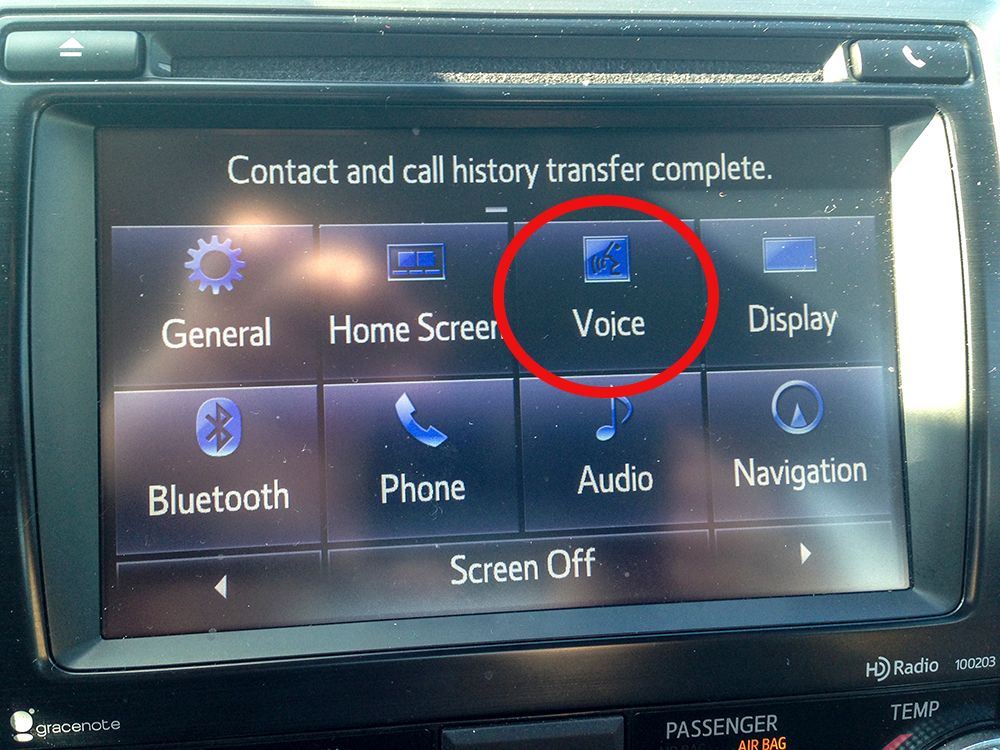

Next, select "VOICE"

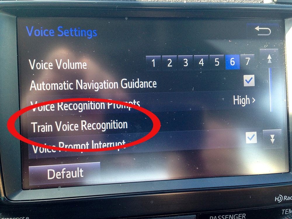

and finally ... select "Train Voice Recognition"
You will then be presented with a series of sentences to repeat so that the system can learn how you say things.
