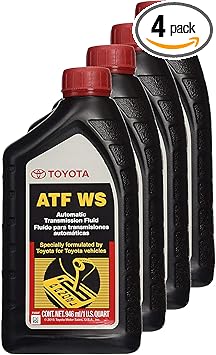

I want to change the transmission fluid of my 2009 Camry (4-cylinder)/5-speed automatic transmission, and I'm trying to find the absolute best transmission fluid available in the market.
So far I have done drain/refill twice at 20,000 and 40,000 miles with the following fluid:
Toyota 00289-ATFWS Lexus & Automatic Transmission Fluid WS ATF World Standard, Pack of 4
Now at ~60,000 miles, I want to change the fluid and treat my transmission to the best possible fluid. I'm trying to see whether the above fluid is the best, or there is anything better out there. (Price doesn't matter; I go for the best quality.)
I would appreciate any recommendations.
Thank you!
