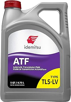

Is there another option on the ATF fluid?
I see this Idemitsu ATF on ebay....
http://www.ebay.com/itm/12-Quarts-A...530&meid=87405657689241a0867769aeea39cd90&pid=100623&rk=2&rkt=5&sd=281831666649
Any comments, pro or con?
