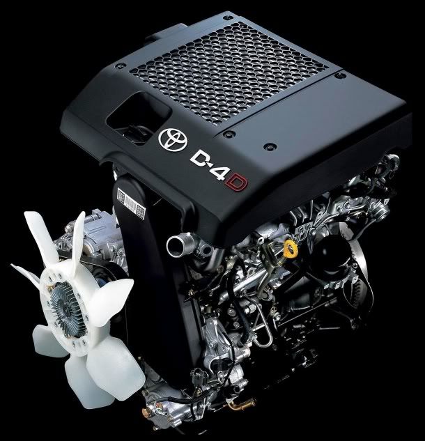

Engine
Engine: 1KD-FTV (II.Gen)
Cyl: 4 "in-line"
Horsepower: 171K @ 3600rpm
Torque: 343Nm / 252lb ft @ 1400-3200rpm
Displacment: 2982ccm / 181Cui
Compression: 17,9:1
Bore: 96mm /3.7inch
Stroke: 103mm / 4.0inch
Injection: Commonrail Piezo Direct Injection
Inj pressure: 1600Bar / 23.200 Psi
Turbocharger: Toyota VNT
Fuel Milage: City 28mpg / Urban 34mpg / Highway 40mpg
