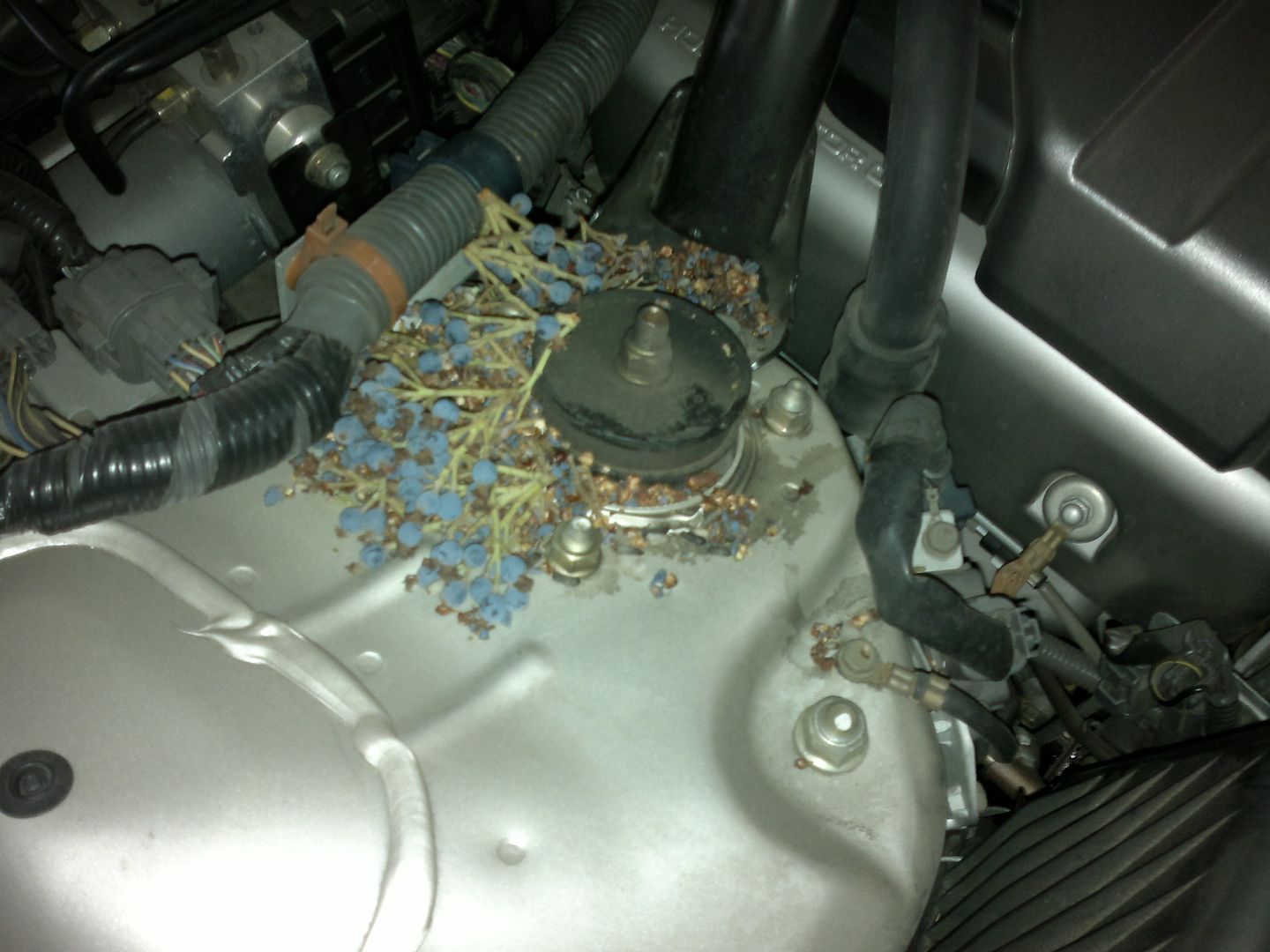

I worked at a dealership for too many years. A dual dealership service dealership, I saw my share of rodent damage.
The weirdest one I saw was on a late model Pathfinder with the complaint, "Vehicle has no acceleration", and my first thought was the fuel pump was dying. So, I was already to replace the fuel pump but fuel pressure was normal. It also had plenty of spark so I check the timing thinking that it jumped time. Again timing was normal, and advanced normally.
So I thought the only thing left is the air getting to the engine. The top of the air filter was normal but I wanted to see if the filter was covered on the back side.
When I removed the filter, the rodents had made a storage area for kibble dog food. The entire housing was filled with it. I pulled the vehicle over to the clean up area and vacuumed out a good four cups of it. A test drive proved that the problem was solved, normal smooth acceleration.
My conclusion would be to 1) Park in another area, if possible. 2) Coat the wiring with undercoating or foam spray to make the wiring unappetizing. 3) I hope this fix will keep those furry guys from tearing up your vehicle.
