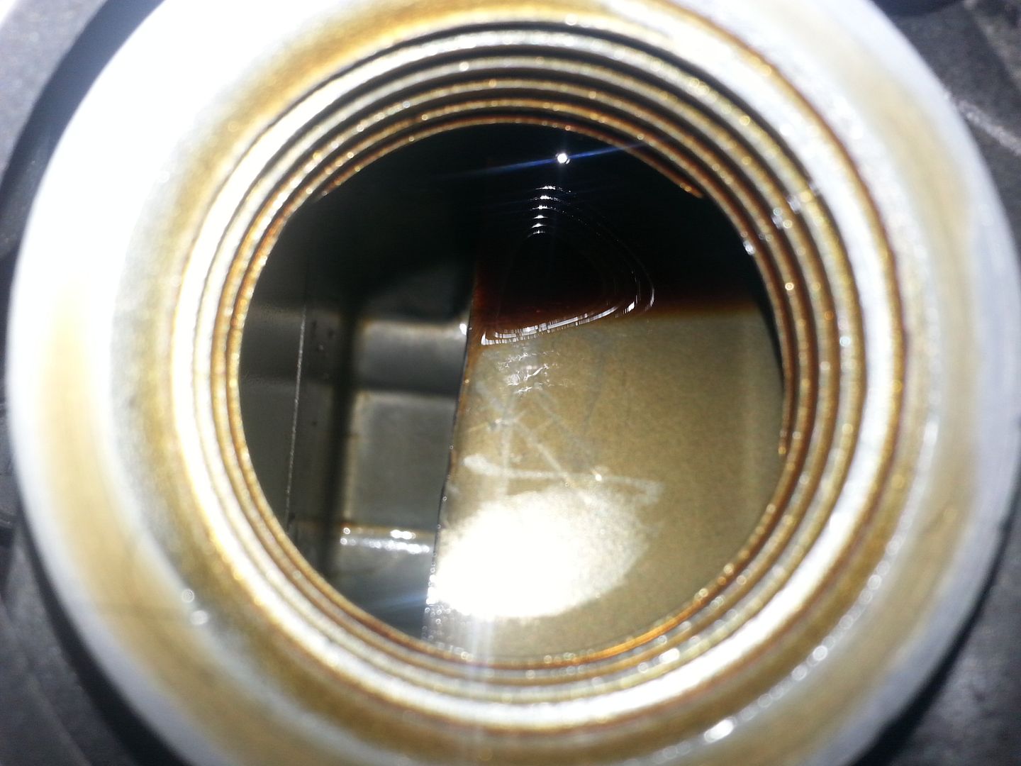

I did perform an informal test with Gunk on that honey colored shellac, when I had my '02 oil pan off a few weeks ago. At room temp, gunk was ineffective on the shellac. Acetone removed it, but not without some elbow grease. I had thought about heating the Gunk to 190F or so and testing it, but ran out of time.
Right now, I am a bit puzzled as to *why* the Gunk made a difference as my skeptic hat is on regarding it's chemical effectiveness. Maybe elevated temps and 20 minutes of swishing is the thing.
What I do know is that shellac can be quite sticky when it's hot and softened.

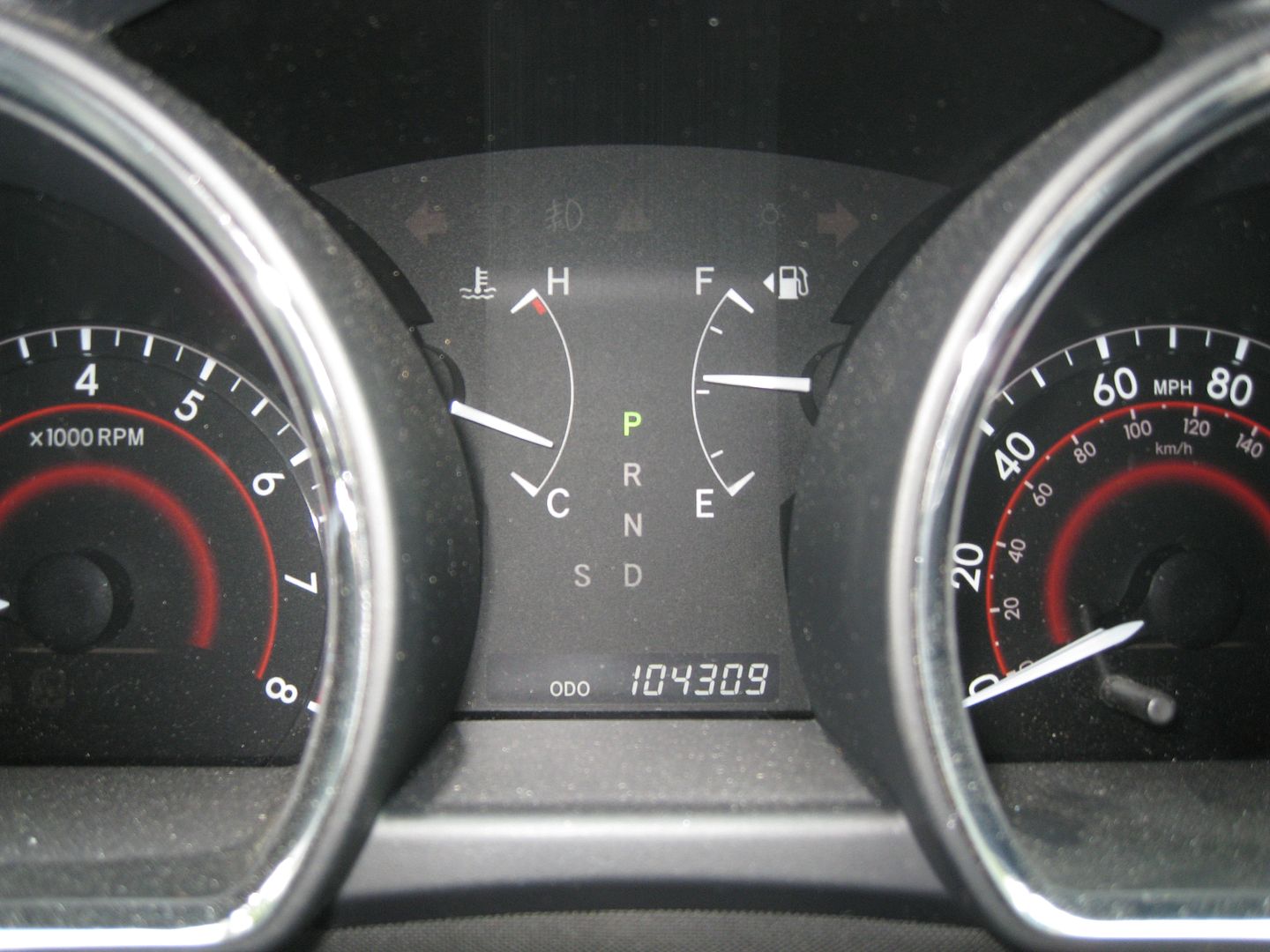

No mine will do it once and only once, it seems once oil pressure is there, it takes a few hours before it will clatter.
Well, I'll give you an example, today I started the car 5 times, it did it 3 times today.
Once at 7:30am (sitting overnight)
Once at 11:20am (after sitting in the parking lot for 3'ish hours), temp gauge was still a tick above C
Once at 2:10pm (car had sat since ~11:50am), didn't look at C mark
And it ALMOST did it (like it wanted to, but oil pressure built up quick enough to counter, you can hear it still) at 5pm after sitting since 2:20pm.

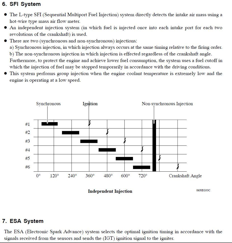

An aside: did verify after the VVti "clatter" in the recording, what must be prominent injector clicking, as it occurs at 3x the rpm rate, which corresponds to a 6 cyl getting fuel spurts every 120 degrees of rotation. I believe there was some speculation as to whether the injectros were making the tickety-tick, especially when cold.
Nothing else in the block or valve train would be at that rate and at sharp impulses, that I can think of. There is a 3x rate broader (lower in fundamental frequency) pulse that must be exhaust related.

edit: Oh and I agree part of that noise in synchronous injector firing during warmup. Coulda sworn I read that somewhere, but now I can't find it.

I analyzed the cold start this morning (if you call 75 degrees ambient a cold start) since I *thought* some VVTi clatter was present. Upon analysis, discovered it wasn't VVTi clatter as the recording lacked the prominent 39 Hz (once per revolution) pattern.
What it did contain was a 70 Hz pattern (it's warmer outside than it was last week so lower startup RPM) twice per revolution pattern that lasted for 0.9 seconds right after the engine "caught". Don't know if that's valve train noise or the synchronous injector thing. Either way, it stops abruptly, where the softer valve train/injector/exhaust pulses remain.
SP--have you scoured the FSM for some mention of this synchronous injector behavior? Any insight?
