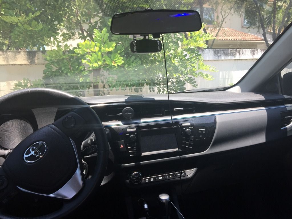

I didn't take a thing apart. I just pushed the wire inside the pillar cover, ran it along the dash in the corner, ran it along the inside of the door, down under the floor mat, and up to the power source.
Here are some pics:
Nice, I didn't bother hiding the wires or hard wiring it. Gonna wait until I get a Blackvue for the stealth install. So far this is how mine is. I just made a few loops around my rear view mirror to keep the wire in place.

I left the a-pillar wire like that because I am planning to hide the wire behind the trim and instead of laying it down on the black dashboard, I just draped it across the trim so that it would heat up less from the sun. (Now I know the dash cam is gonna be baked but I am preventing things where I can).
I ran the wire from the passenger side under the glove box (its literally a cereal box tab that you press to open the tray and u throw the wire on it and then u push it back up to close. I think specifically it is the cover for your pollen filter and AC fan motor since that's what I saw when I opened it). I just wasn't satisfied with throwing the wire under the rug so to speak.
