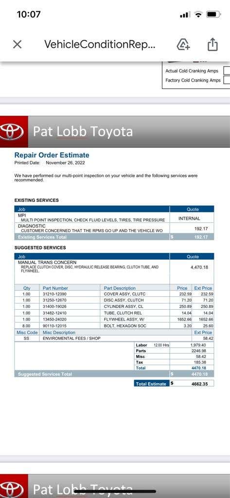

Ok so fast forward to this morning, my local Toyota dealer gave me their “estimated repairs” quote. They are stating it needs a new clutch assembly and flywheel. Over $4600 total. I was almost speechless. I asked how they know that, and the advisor said their master tech just knows it will need those parts. My initial thoughts were possibly the master or slave cylinder had died. Not a total clutch failure. This doesn’t seem right at all.
Has anyone had an issue like this on their Hatchback? Clutch pedal won’t return to its normal position? I’m attaching a screenshot of the estimated repair quote also. Any help is much appreciated!

Quick update, I called back to talk to the service advisor. I let him know my concern that this is a master cylinder issue. The fluid being low would also point to that being the real problem. He assured me they are going to check that first. So now I’m wondering, did they even look at my car?! Or just throw a $4600 repair bill at me and hope I take their word for it? I’ve used their service department many times, and it’s been some good and some bad experiences. 🫤
My car has 46,000 miles on it. So not enough miles to easily justify the clutch is destroyed or ruined.
He couldn’t give any explanation on why the clutch assembly OR flywheel needed to be replaced. Just that the master tech evaluated it. Nothing has been taken apart yet. I’m starting to think they didn’t even look closely. That ‘cylinder assembly’ listed could be a new master cylinder? The part number doesn’t match though. Looking online the master cylinder is 31420-12090

That uses a hydraulic clutch throw-out bearing, if it is failing it could be where your fluid is going and in that environment between the heat and the bell-housing it's not gonna make it to the ground.
If it did go the disc is gonna be saturated but the cover and flywheel would be fine unless you experienced some slipping.
I doubt it needs all those parts but the trans has to come out to fix it.
Wearing a disc out or overheating a flywheel can be attributed to a driver but the failure of that part this early seems like a warranty issue.
That dealer's parts prices are ridicules compared to other dealers. Time to look else where.
The majority of dealers, some in close proximity to that one have th at $160- $165 bucks.

I didn't even check, that is what they were referring to as the cylinder! Nice going @sdspeed! Still a premature failure nevertheless! 😁
