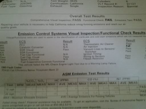

Hey guys. joined the forum because i cant pass smog with my 02 v6. has a p0430 code. thats why it failed.

so i finally got to change the exhaust manifold cat closest to the radiator. cost almost 550$ for the manifold. the Check engine light is still there. if i corrected the problem from changing the cat how long until the check engine light clears?
the picture shown isnt the full image. its missing like the last part. it failed because of a MIL light. like it shows first result then ecs, result-ecs , result-ecs etc. its not showing the last Ecs
