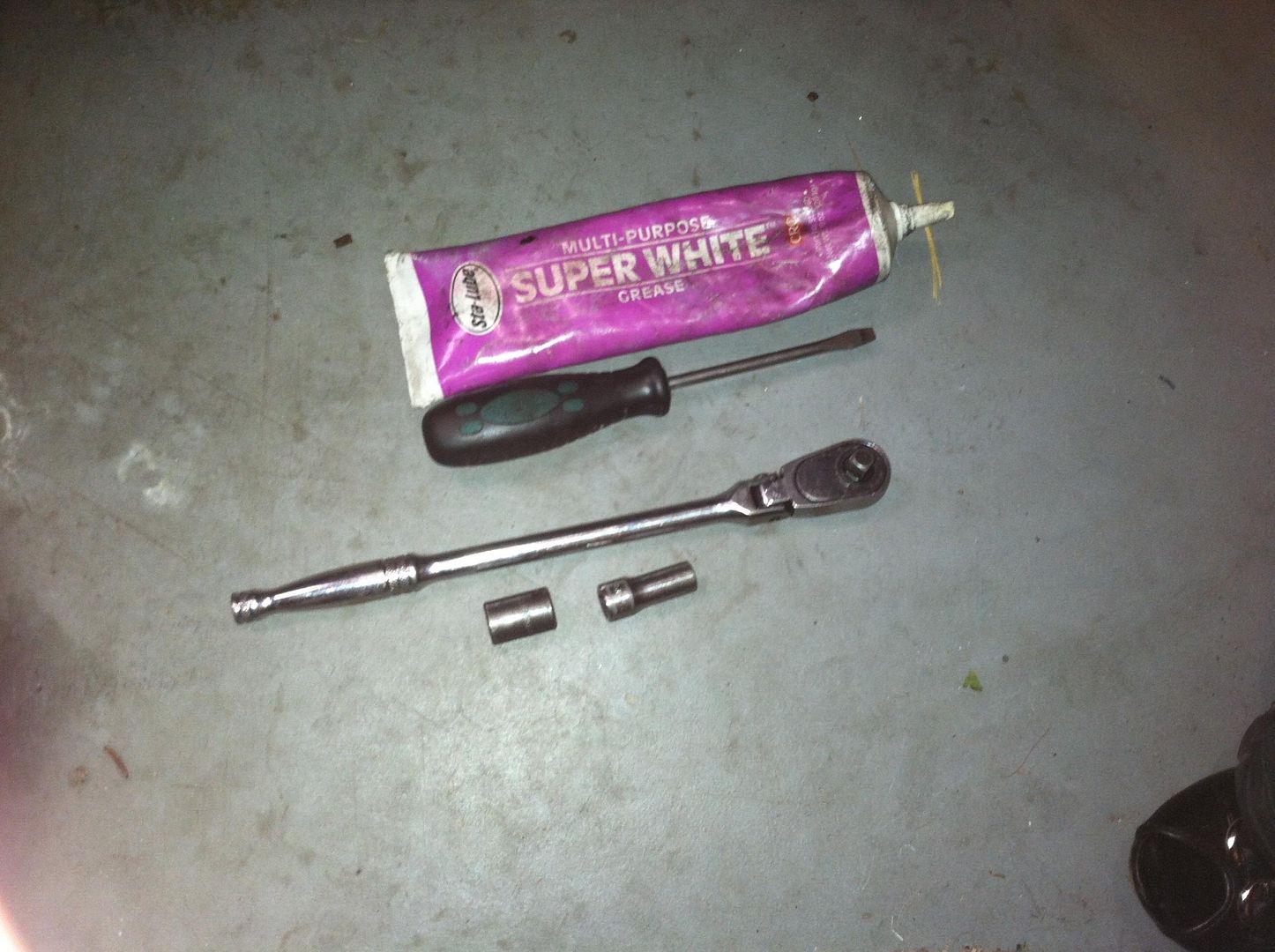

This thread may be of some help.
#23 ·
It is likely the pivot ball and fork being noisy in the slave cylinder.
