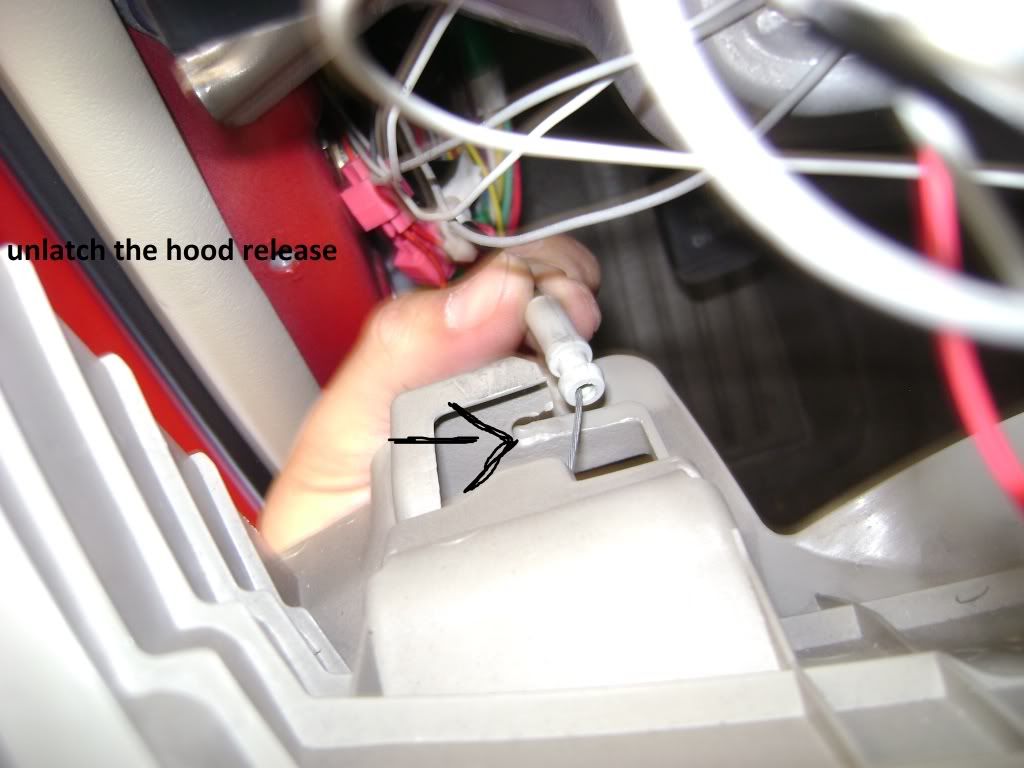

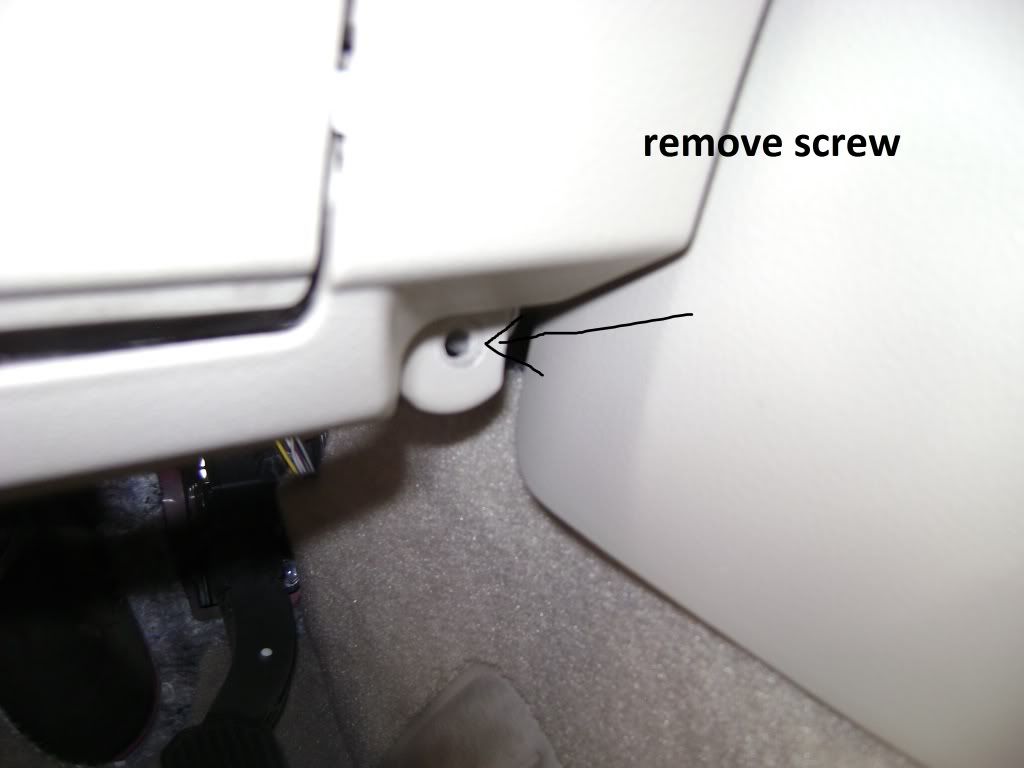

remove door panel
After removing door panels,take out your old mirror assembly and put in the new one.Then do this:

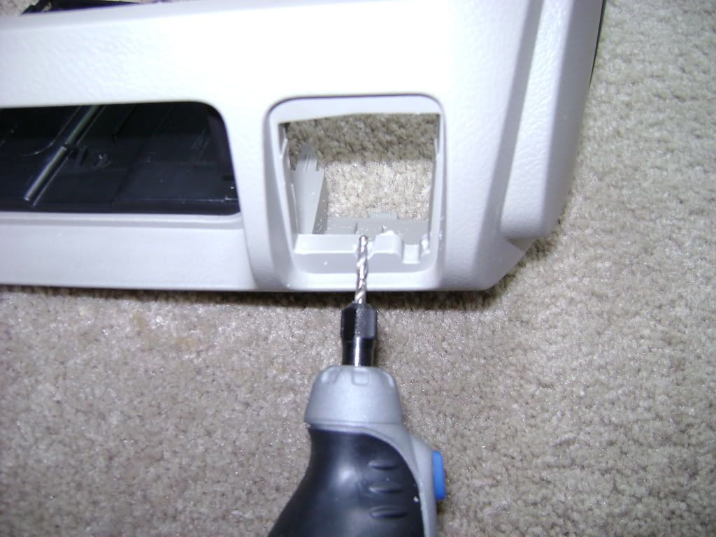

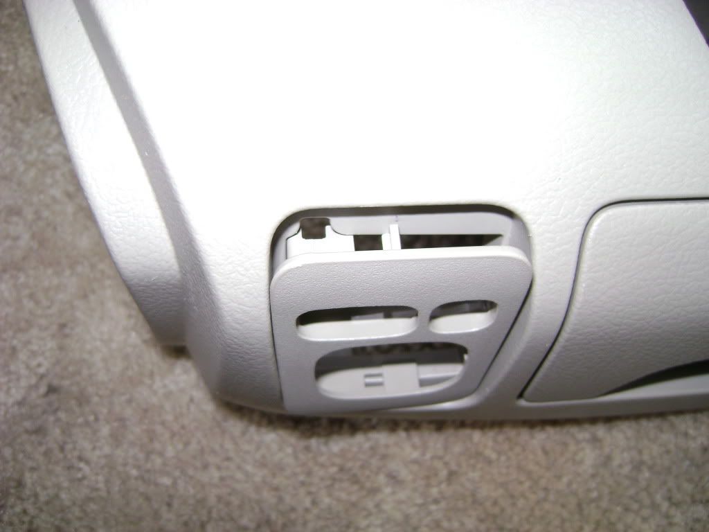

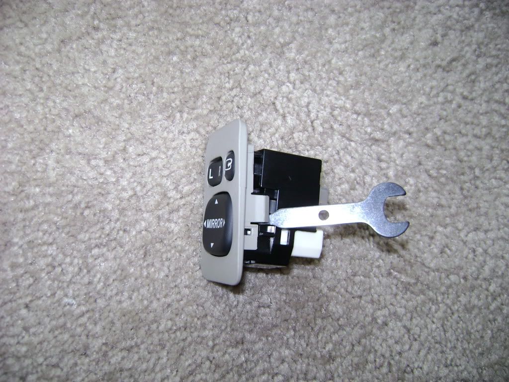

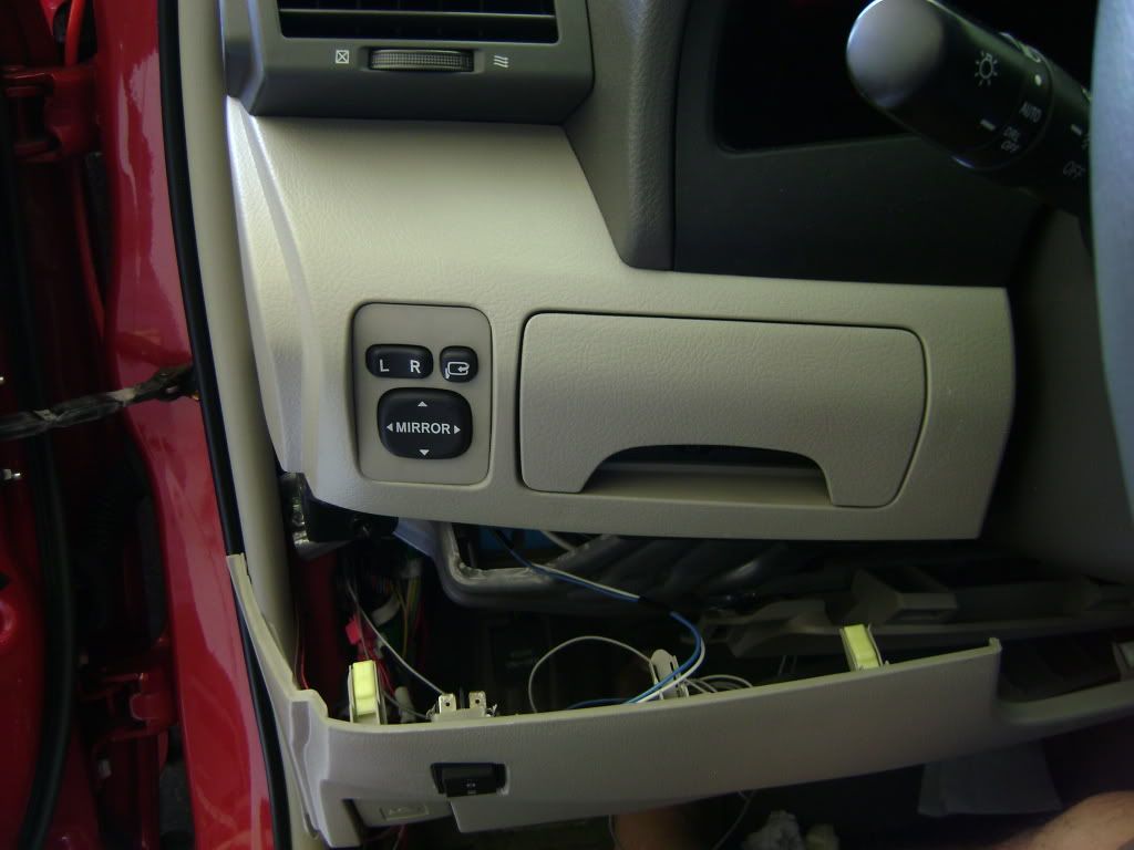

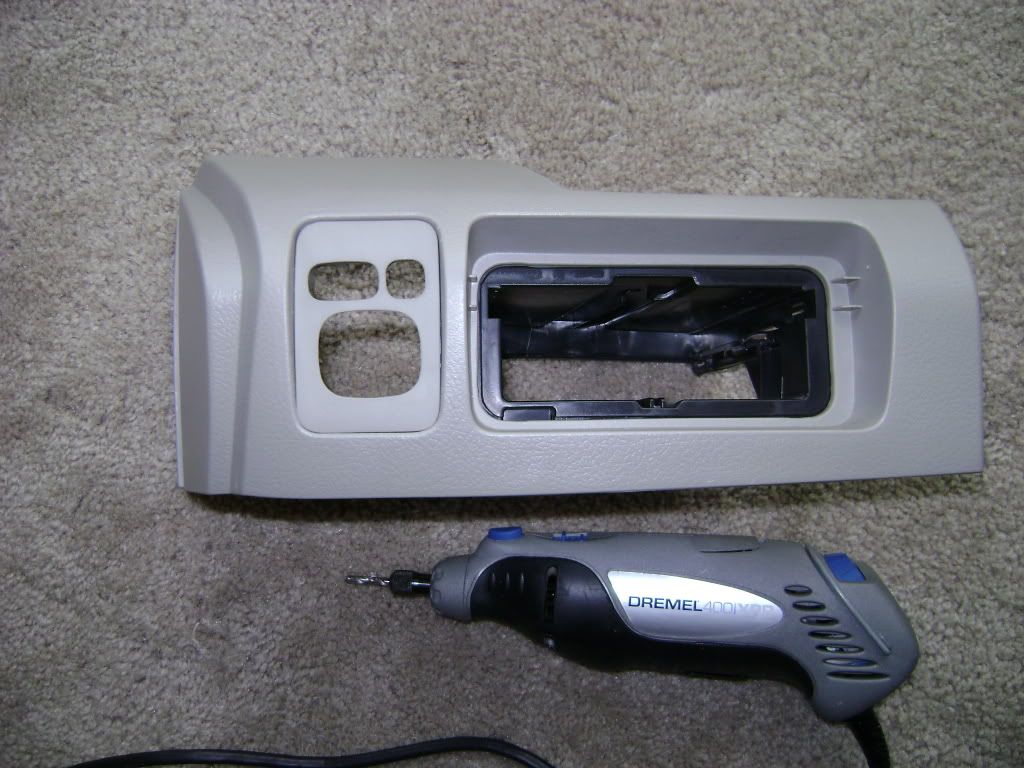

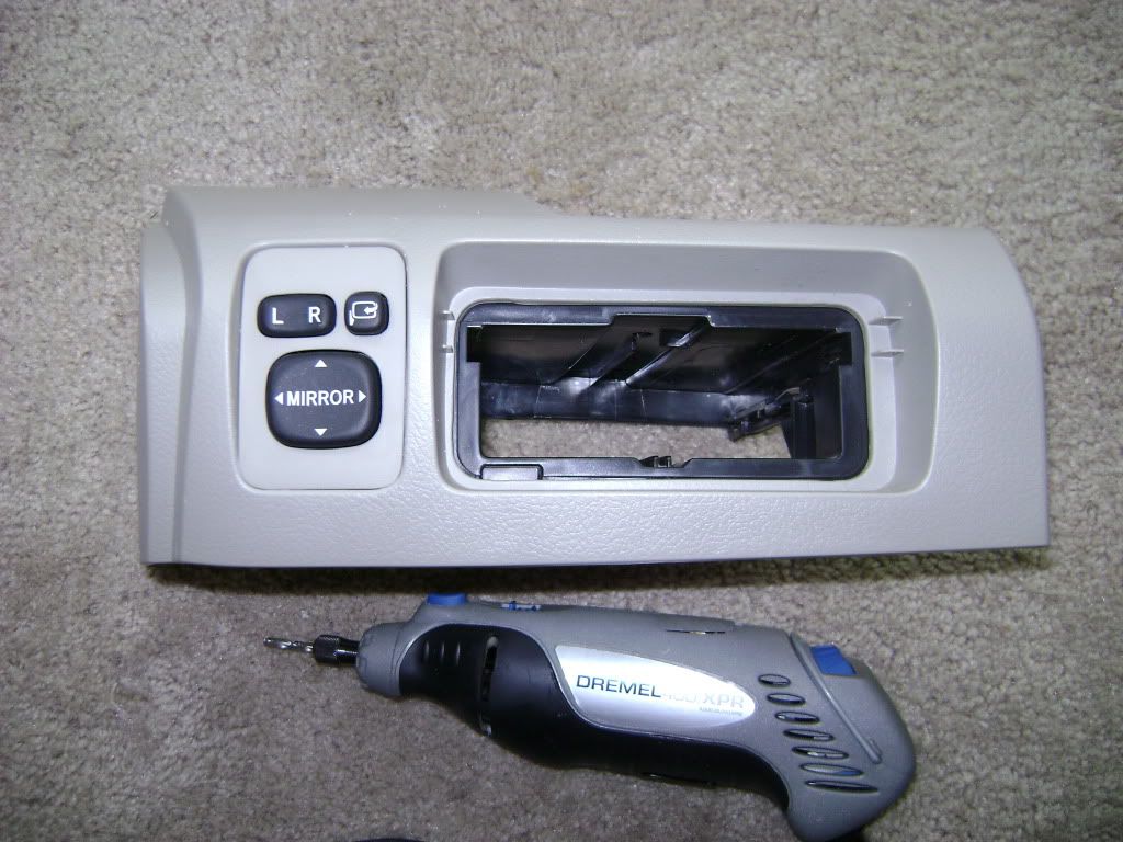

Next we will need to modify the mirror switch panel a little in order for the JDM switch to fit as it is shaped a little differently since it is was made for RHD Camry and also it has a notch in the middle instead of the left.You don't really need to do the next two pics but i just wanted to show the notch more clearly.When you make the new notch on the panel though,make sure to not cut too much so the switch assembly will not be loose.Cut a little and then test fit each time.

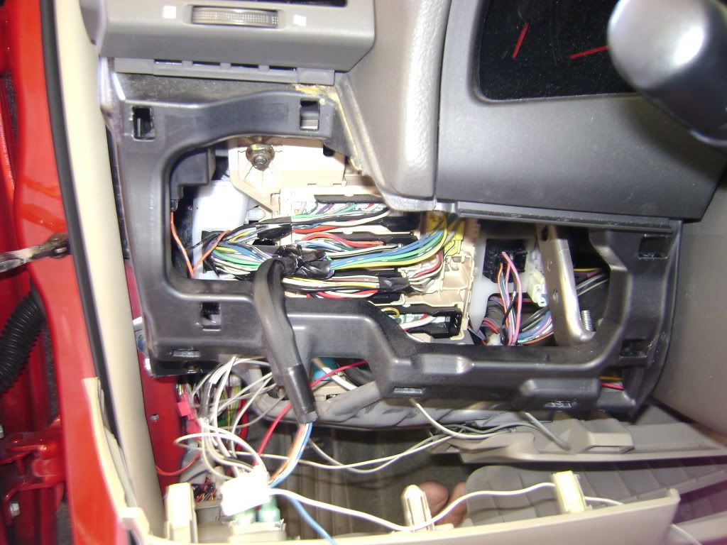

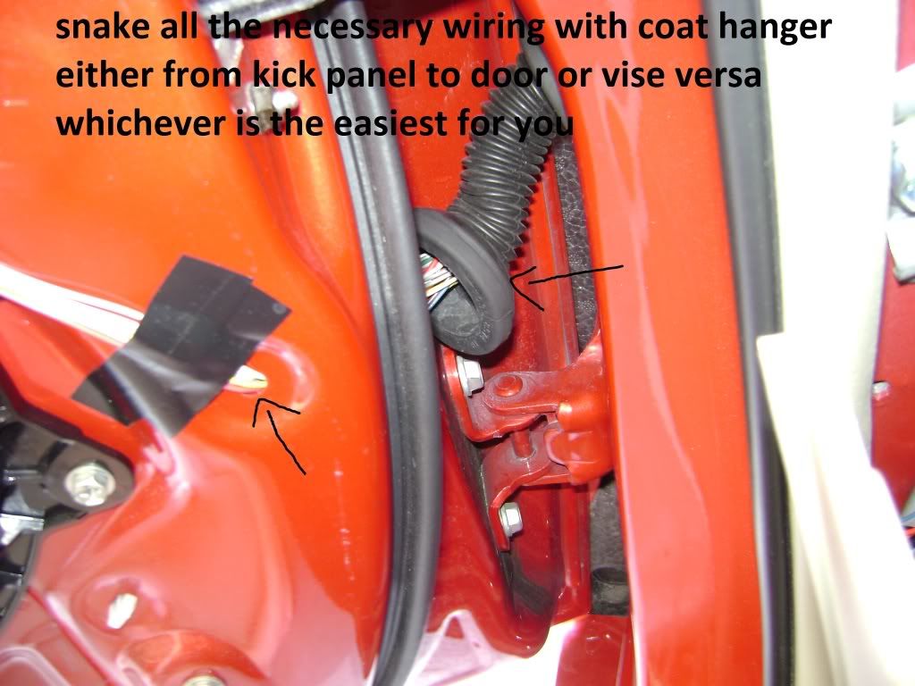

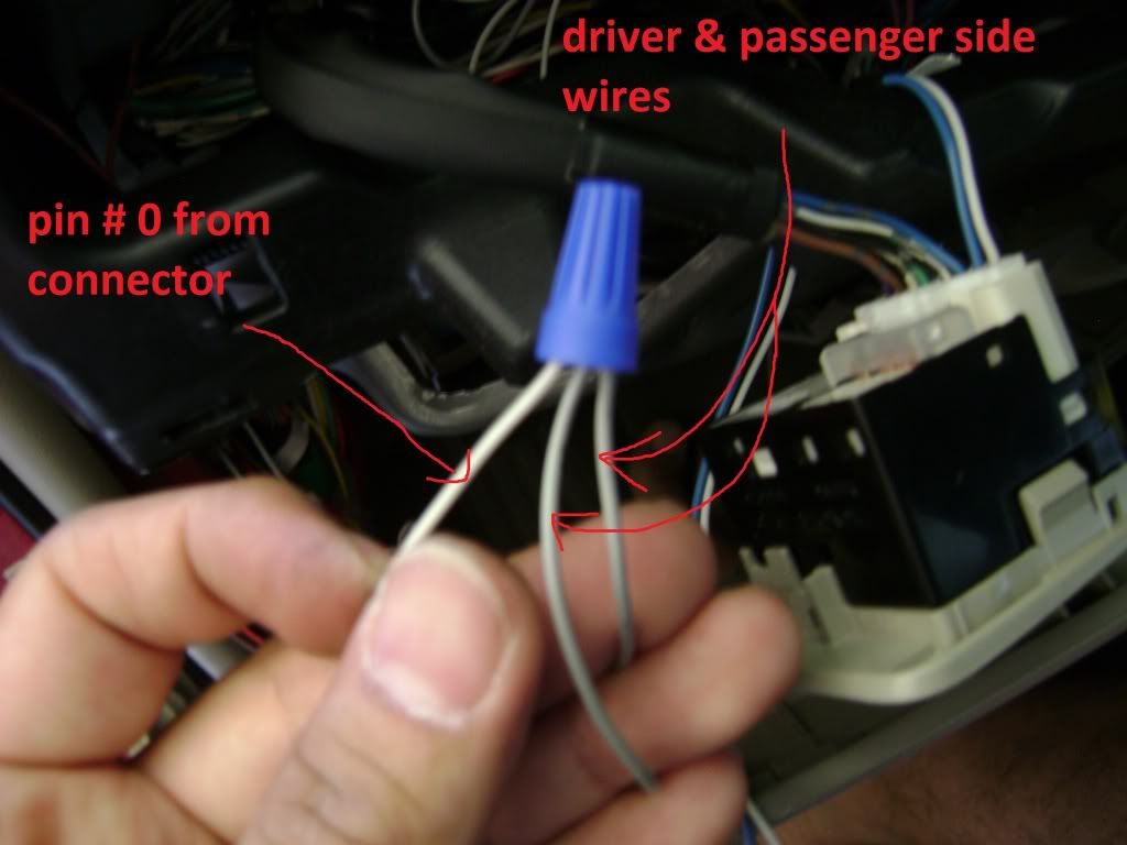

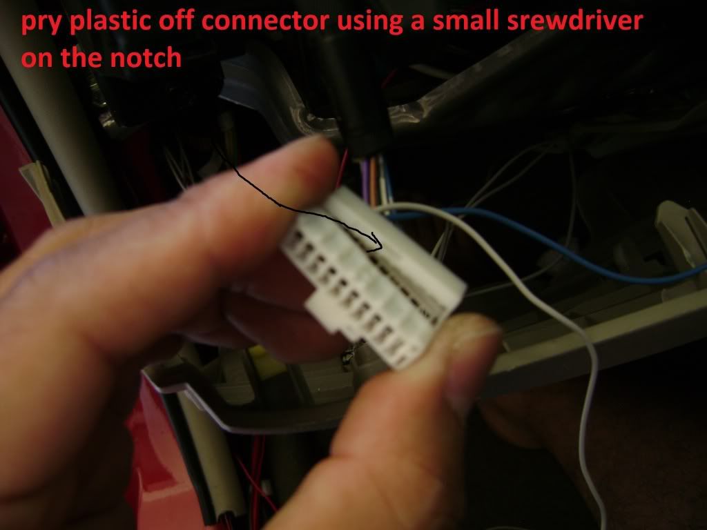

Now we can do the wiring.First cut the necessary wires to their length and snake them through with a wire hanger so you won't have a hard time later.Four wires on each door.2 wires for LED signal and 2 wires for power fold function.

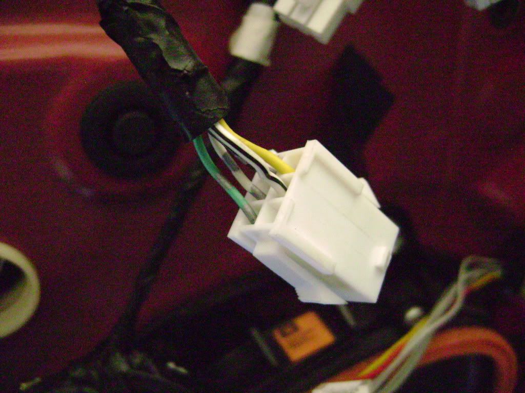

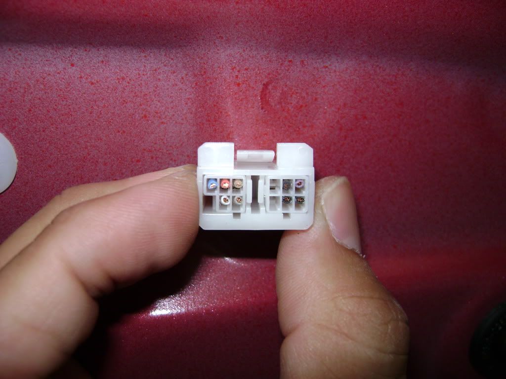

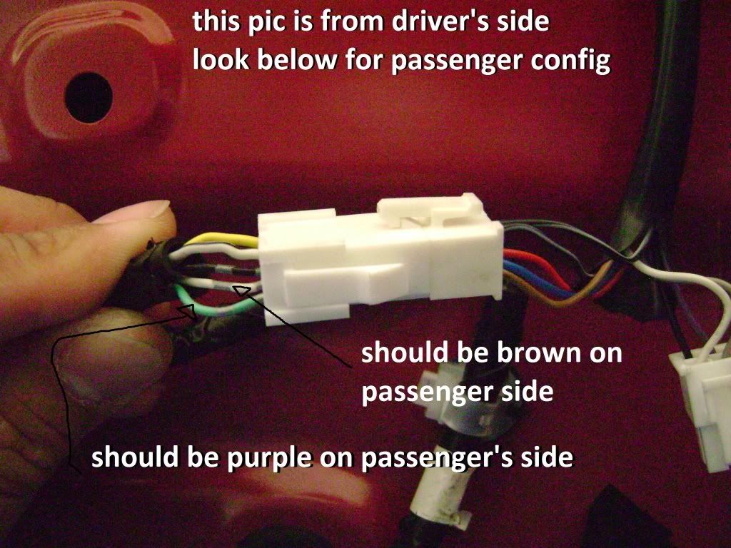

For reference,this is how the USDM driver side connector looks like

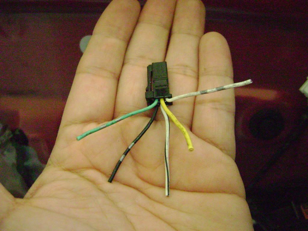

This is the connector that came from the LED mirrors

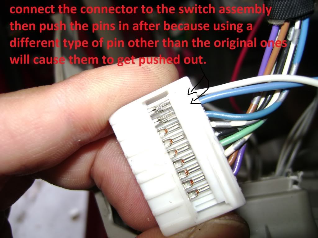

Can't connect them so i had to make my own connectors like this.Test to see all functions of the mirror adjust works and if you have heated mirror option,test it also.

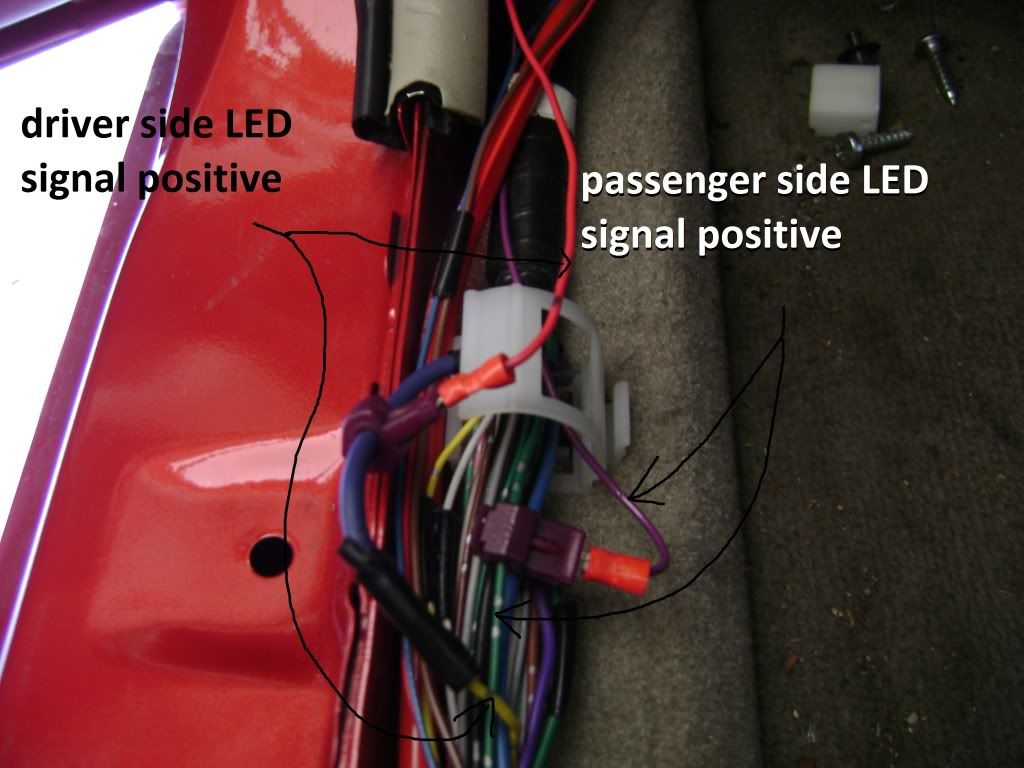

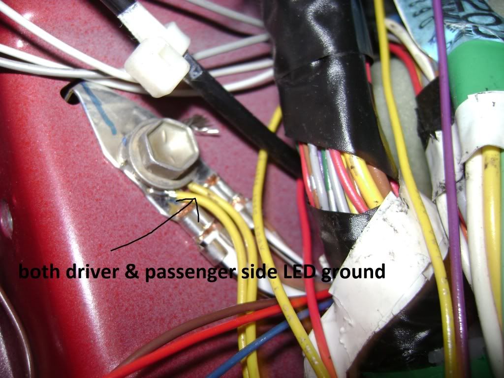

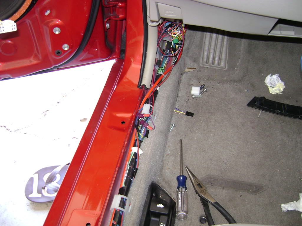

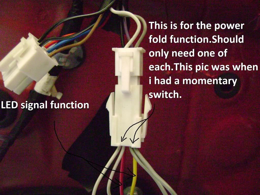

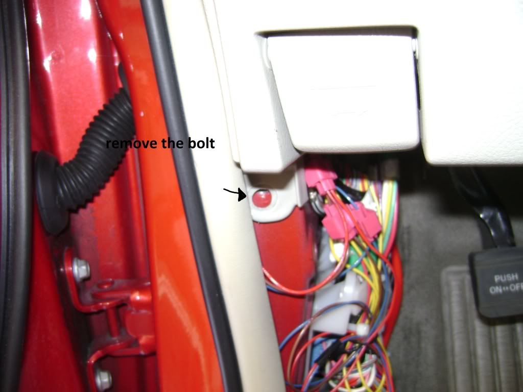

For the LED signal,tap into the wiring by the driver's side door sill.This is a little tricky as some of them have the same colors on the wires.As you can see from the pics,i made a couple of mistakes too:facepalm:.This might change also with the 2008-2011 Camry but for the 2007 Camry that i have,the yellow with silver stripes is for the drivers side turn signal and the green with silver stripes is for the passenger side turn signal.From what i notice though,the wires were at the top of the pile instead of the bottom but you'll never know.Proceed with caution:lol:.Test to make sure they work.

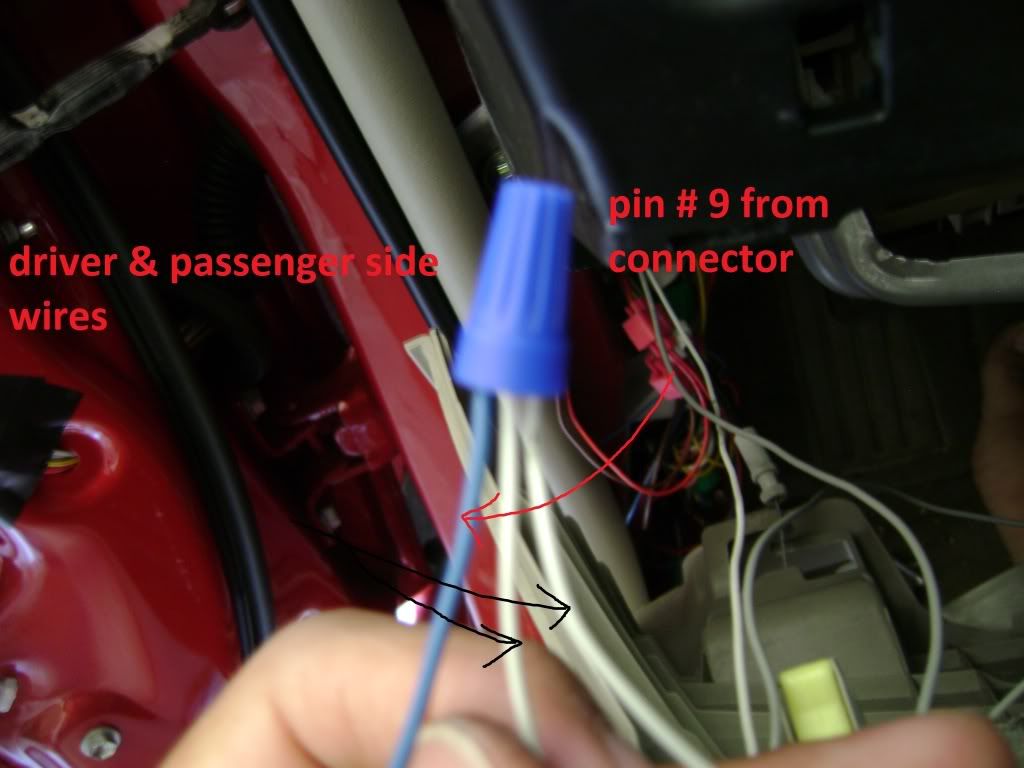

Now for the power fold connection.We are going to need a different kind of molex pins than what we used on the other ones.If you can hunt down the exact same pins that Toyota used,then your all set.If not,then you have to get the best fitting ones for the connector.You can see from the pic that the one i used are a little bigger and i had to push them each time when i connect the connector to the mirror switch assembly because they get pushed out.As a result, i can't put the plastic cover that i took off from the first pic since the pins were bigger.

I received my LED heating folding mirrors and ordered the JDM switch (wonder when I will receive this too). I looked at the link below along with the picture on the first page (pin #0, #1,... #9) on the JDM switch but couldn't figure out which pins are doing what. Could anyone please show me which pins control left, right, up, down, and folding?
http://www.toyotanation.com/forum/showpost.php?p=3210257&postcount=21
