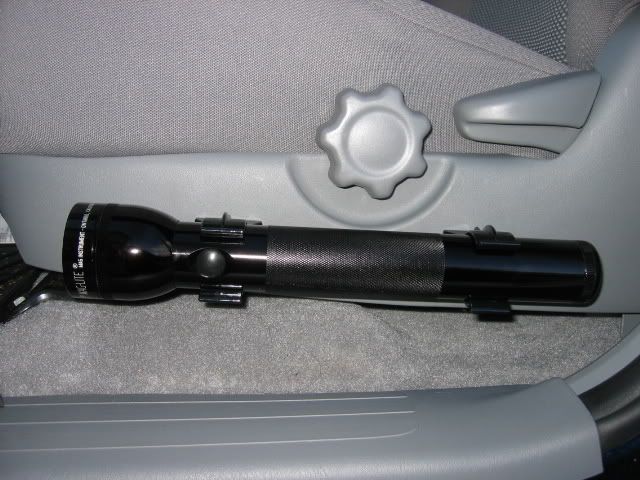

mine sits right beside the seat, without anything to hold it in place. it just rests against the door sill scuff panel, 3/4 of the mag light sits behind the access cab door so i know it wont fall out when i open my driver's door. i had it in the door panel before but it rattled to much, and i was going to do what you were talking about but, the plastic is very flimsy. people have done it where they have reinforced the back side of it with metal but still i hear from almost everyone that "care" is needed when taking the light out of it's mounts which, if you need to grab it quickly to beat somebody with it, that's not really an option. mine doesn't even move around at all, it sits firmly in it's place. just try setting it there and drive around for a bit, you'll see.

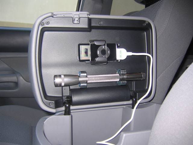

#19 ·
leave it to Toku to do something sick like that. i like that ipod mount very much, mind sharing what kind and where bought? it looks like one i saw at autozone. is that the one?

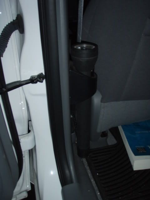

Here's my StreamLight SL-20X. The local police/fire dept uses it. My cousin is a fireman so he hooked me up. It comes with two charging cradles so you can mount one in your house and one in your vehicle.
I ran the wires behind inside the pillar panels to a 12V source. Also, added a switch to the charge cradle so I can turn off the charging; did this because it's not good to charge batteries in frozen state during the winters.

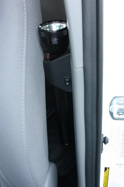

Yes pretty easy access, although I would recommend mounting it about 1" lower than I did. The B-pillar curves inward and the top of the flashlight touches the b-pillar just as I can fully remove it. But it really isn't a problem .. just an improvement if I were to do it again.
I like how rdsaustintx did his install, but i like it higher up so:
1) I can reach it
2) less likely to interfere with the seat
3) no one accidentally kicks it.
I also hardwired the power so that it runs behind the b-pillar. Clean install.
