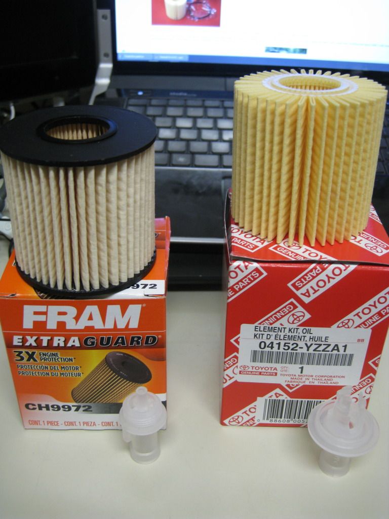

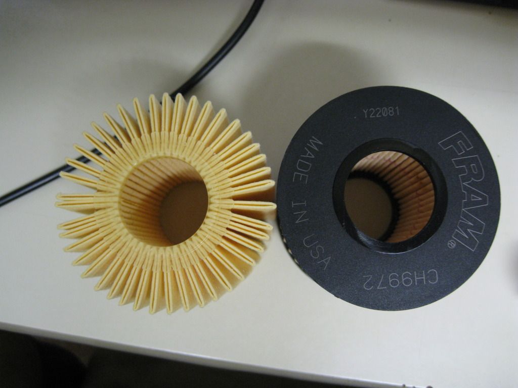

Facts are this: I could care less what filter goes in the engine. I was comparing the budget fram to the OEM because they are the same price. If you look at them...they look the exact same:
FRAM:
OEM:
So there is no special end cap or whatever. Maybe its more efficient, but with modern engines/oil...the extra efficiency is almost overkill.
The reason I use OEM is that, regardless of what you think about false accusation on FRAM...true or not, they exist. There is no way all of them are false, and I rarely hear anything bad about OEM. I only hear people raving about these filters, being great bang for buck. Does FRAM (or other companies) make better filters, sure. But not for $5.

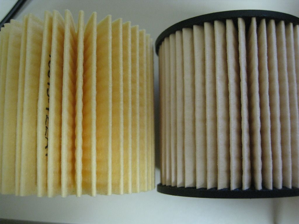

I take back what I said about them being identical. Looks like FRAM has updated their fitlers. I was at Walmart picking up oil for when I change it tomorrow (btw for anyone who does their own oil the Pennzoil Platinum 5w-30 5qt jugs are only $19.95 right now) and decided to pick up a FRAM filter to use next time (after I use my OEM one). And they are definitely different. Was the same price as OEM and well I'll yet yall decide which is "better". I still think a filter is a filter :lol:. Also worth noting the stupid plastic oil canister drain...thing... was the wrong one for the 2GR-FE. I'm just using the one that came with the OEM filter.
If you don't mind, how about an experiment? I'm interested in how a "end-capless" filter media may perform under oil pressure. Find the media seal on each filter. The seam where the pleats glue/clip together.
  • What are the seams connected with on each filter? Glue? metal?
  • When you "fan" or stretch the media near the seam, which one provides the best resistance against the seam letting go/being perforated?
Where I'm going: Without end caps to keep the media pleats stabilized and in place, oil pressure could stretch and flatten the pleats. Possibly pulling the pleats apart at the seam, leaving oil passing straight through without filtration.
#31 · (Edited)
I can't test the FRAM since its currently soaked in oil inside the engine :lol: But I can comment on what I remember.
The Toyota has the mini plastic caps at each end, but beyond that its all held together with glue. From what I saw of the FRAM, its all glue as well.
As for which one resists fanning out the most it depends. The toyota one is very resistant to that. It won't move inside of the plastic caps on the end. The fram though was iffy. 1/3 to 1/2 of the filter "arms" (not sure on the term) weren't attached to the plastic end caps. Those moved and stretched FAR easier than the toyota one. But the ones that were fully attached were just a hair more resistant than the toyota one.
As for at the seems, I can't comment about the FRAM as I didn't look at it, but the Toyota one doubles up the arms there. Instead of being spread out, they are side by side, and I have to really push it to separate it outside of the plastic cap. Inside of it, its totally immovable. I don't think its ever coming apart.
Overall, it seems the fram has a weaker media, but if the glue is present it can match/slightly outperform the toyota in strength, but the toyota is very strong without any support on the outside edges.
