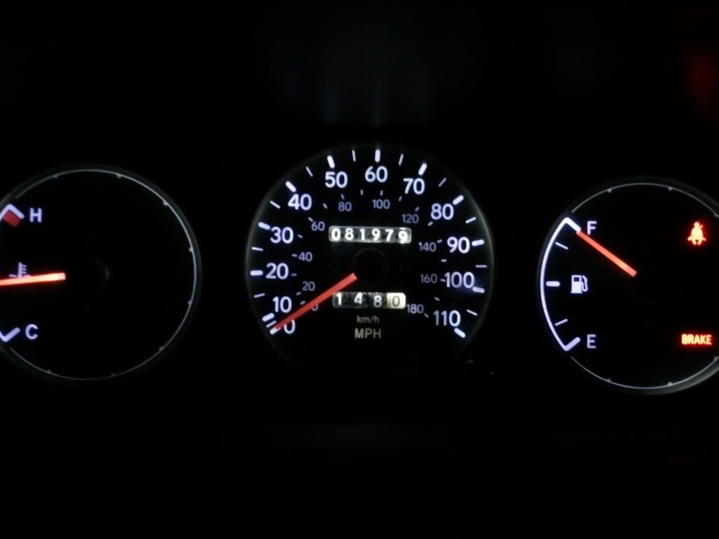

I took these 9 LED 194 socket
http://superlumination.com/images/auto_bulbs/194_smt2_w_wm.jpg
and stuck them in my gauges and it came out like this,
I think it looks amazing. For all of you that are still using bulbs in your gauges, do this! Its easy and looks better.
Here is the website, its the second one down.
http://autolumination.com/194.htm
I used white but they have other colors.

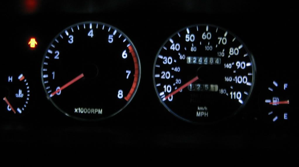

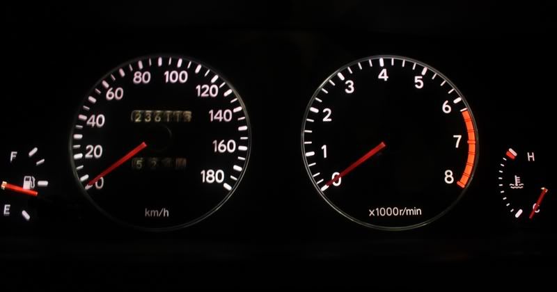

The non tach gauges take 4 of these. I think the one with tach takes 3. Someone correct me if I'm wrong.
I ordered the 4-star SMD LED bulbs from autolumination ( 4 LEDs on top, none on side) and they sent me 5. I ordered four of them, but one didn't work. No return policy either...
Mine were super-white but they have a purplish tint to them when they're shining through the speedo numbers. The mileage dials look completely fine (straight bright white) but the MPH and everything else thats transparent has that purple tint to it.
Kind of dissapointing. :(
But hey, better than the greenish-white that was previously in my speedometer.

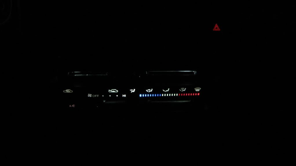

1 74xhp3 in cool white for the hvac
http://www.superbrightleds.com/cgi-...om/cgi-bin/store/index.cgi?action=DispPage&Page2Disp=/specs/74-xHP3.html#photos
sometimes the lens for the hvac is a bit burned from years of use, i used a dremel with a cutting bit to clean the burned stuff out.
ill get pics for you guys soon, looks good so far though!

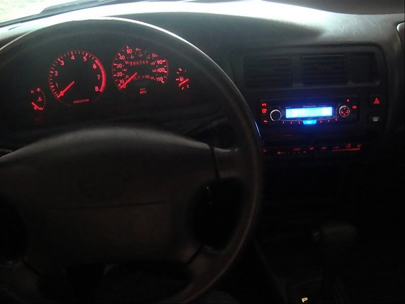

I'm a sucker for blue because it matches my interior. I've used one with an inverted lense so it lights the gauges but not the rest of the dash, giving a cool, subtle feel to the lighting of the gauges. I still haven't found a bulb yet for the center dash, I can't remember which size/type though.
