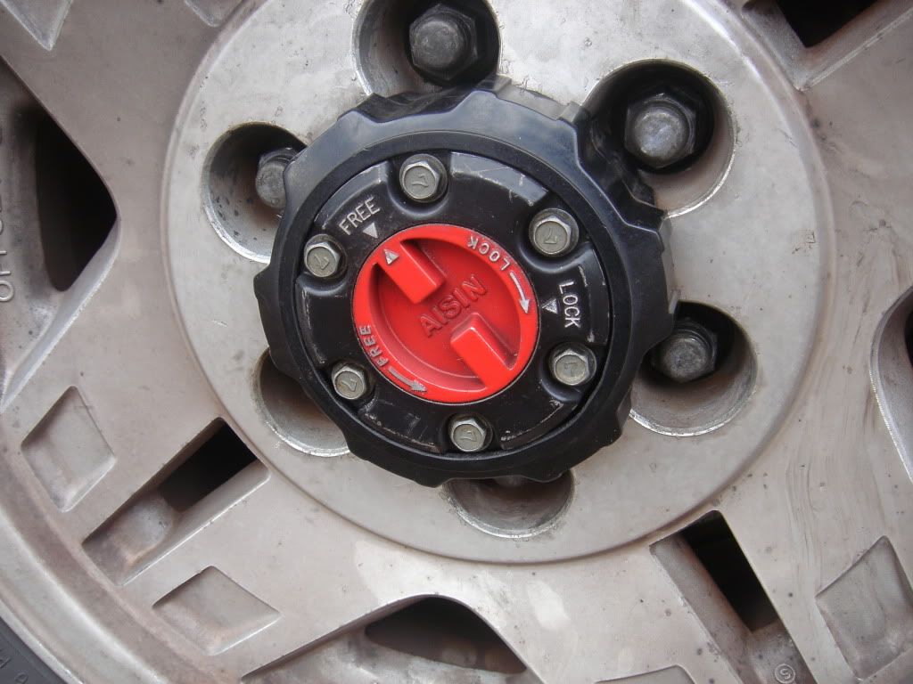

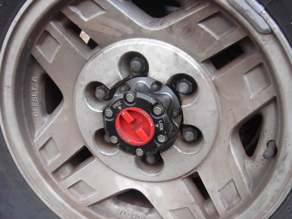

I just installed a set of the Aisin hubs on my T100. I picked up the pair at a 50% off weekend event at the local salvage yard for...22 bucks!!!! Great Deal! :clap:And they looked like they had hardly ever been used (internally). They need to be repainted but I was too excited and didn't want to take the time to paint!:D Anyway, I paid a total of about $35 for new seals (from Toyota only...and required) and another $25 or so for new stainless hardware (from Lowes, not required).
And I must say...This was a fun and cheap way to retrofit the T100 to reduce the wear and tear on the CV joints and boots. And they look sweet! I followed the numerous online guides to rebuild and install the hubs, and they work like a charm...a true bolt-on with none of the side effects (other than having to get out to lock the hubs to use 4WD). I highly recommend this mod to any 4WD T100s that see only occasional offroad use (like mine!).
And just a note...the hub rebuild is a little tricky but not bad if you follow the write-ups closely. BUT, the rear snap-ring was a bear to get back on (they didn't have the little grooves for the snap ring pliers). Persistence, a flathead screwdriver, and a little muscle and grease (both elbow and wheel bearing) will get it though. :thumbsup:

Dont toss those center caps.......
So i finished rebuilding and installing my new Aisin hubs and i used a few threads i found on TN and other sites. The whole project went very smooth but all the threads i found end up the same way; with something that looks like this
I was just wondering if any one else had noticed that if you take the old center cap and cut out the center you end up with this :D
made for a much nicer finish :thumbsup:

I thought about doing that, but two things stopped me. 1) I was afraid of water/gunk getting trapped on there and not drying out and causing corrosion. And 2) I have the Enkei wheels and center caps, and the stock Toyota black caps don't fit. I didn't want to risk messing up caps I can't get replaced! :D
But on second thought, I guess the caps are designed to not hold water, so maybe that isn't a concern.
Looks great! :thumbsup:
