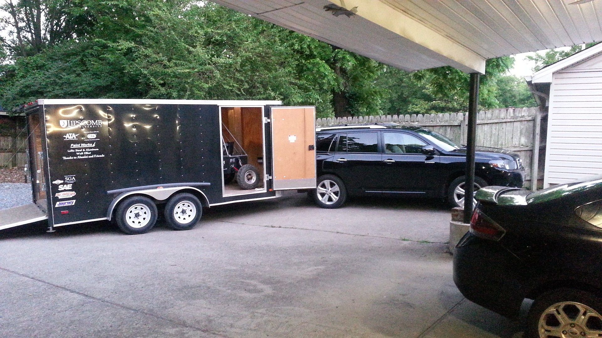

I will say however, its funny seeing people's faces when you pull up with a trailer like this. Those longer trips with the fully loaded trailer, I was going to big collegiate competitions (SAE Baja, you can see the car in the pic. That trailer is filled (when loaded) with an offroad car, generators, welders, compressors, plasma cutters, metal, etc... it adds up quick). Everyone there had 3/4 tons or modified 1/2 tons. Some had duallies. I got more than a few weird looks when pulling up with a HL :lol: I even had one guy pointing at the trailer/car/trailer/car going :wtf: Got a kick out of that.

I actually just got back yesterday from a 2500 mile trip over the last 2.5 weeks (well 2 trips, one 1.5k and one 1k) towing this trailer (7x16 cargo trailer):
Having pulled that through some pretty bad storm yesterday in Illinois and Missouri, I can say a few things on how the HL handles high loads. Oh and to put it in perspective, its loaded over the stock HL ratings. It weights ~5500-5800lb, and I had originally put the tongue weight at 500lb (I use a scale to load it correctly), but it swayed bad so I pulled over and reloaded it to 600lb on the tongue. I also had 5 people in the car and a trunk full of suitcases/printer/paperwork. I was at or over the GCWR of ~11,000lb.
