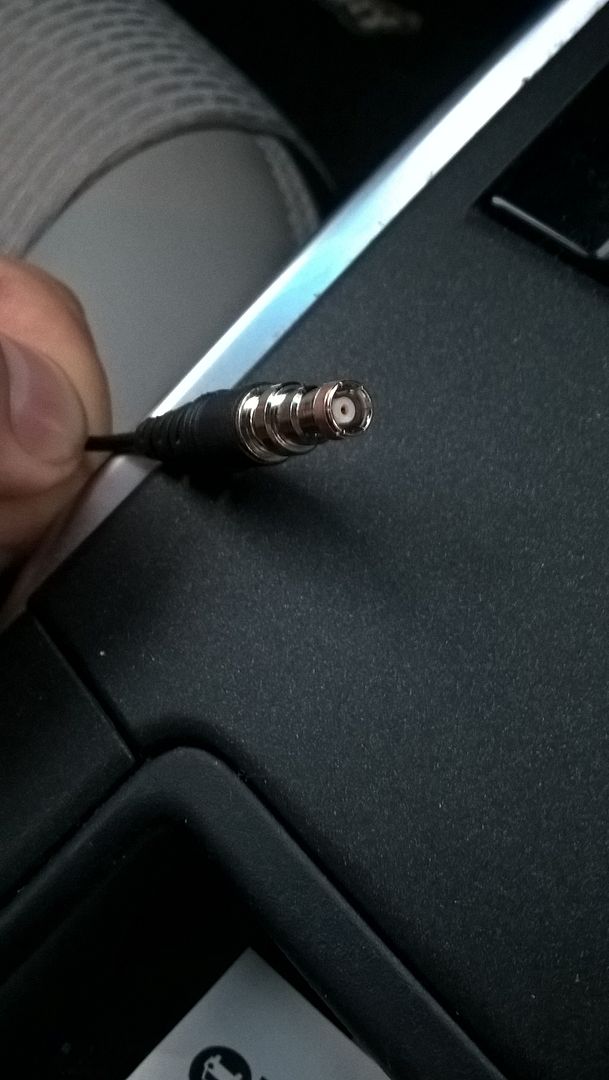

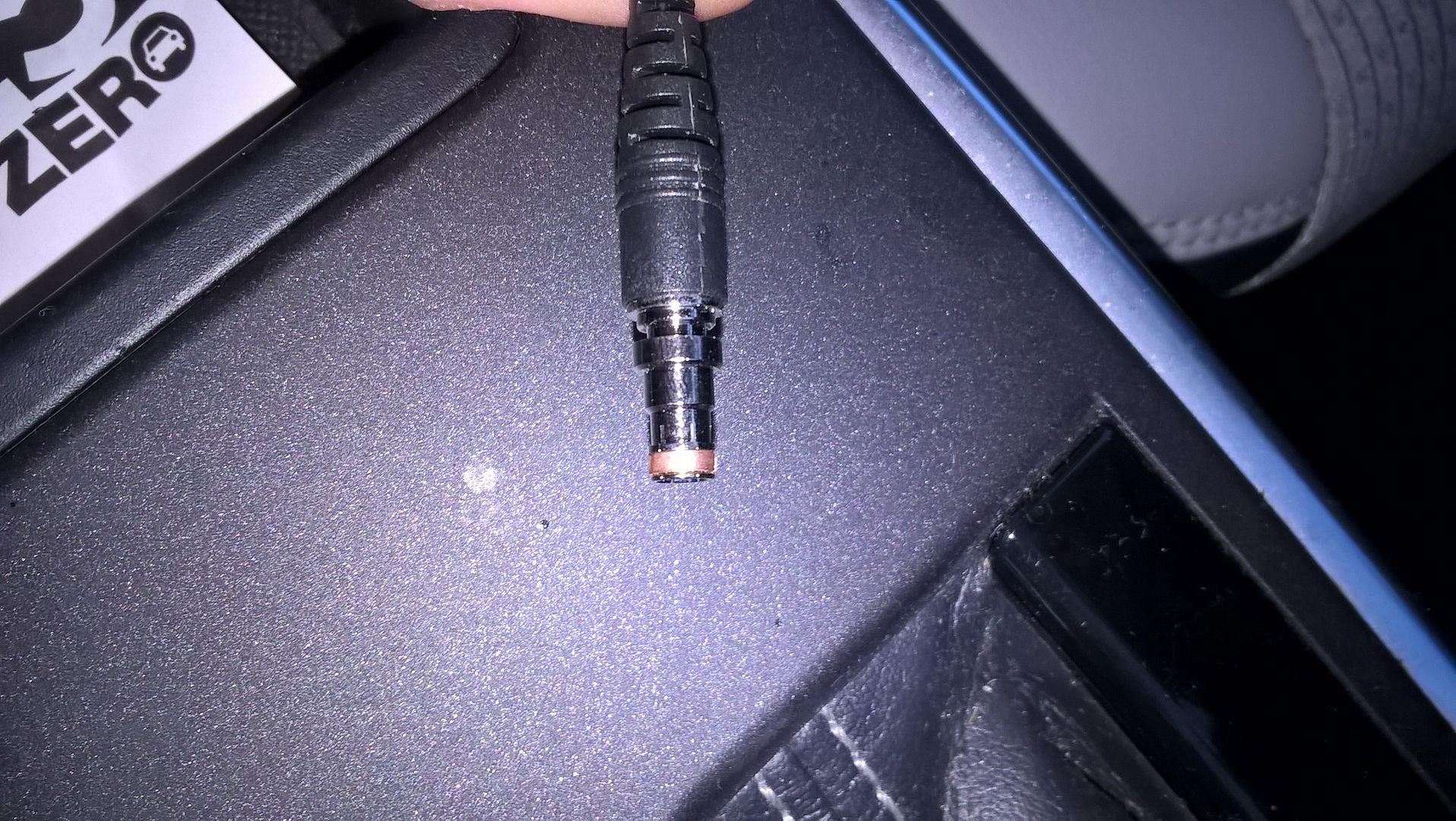

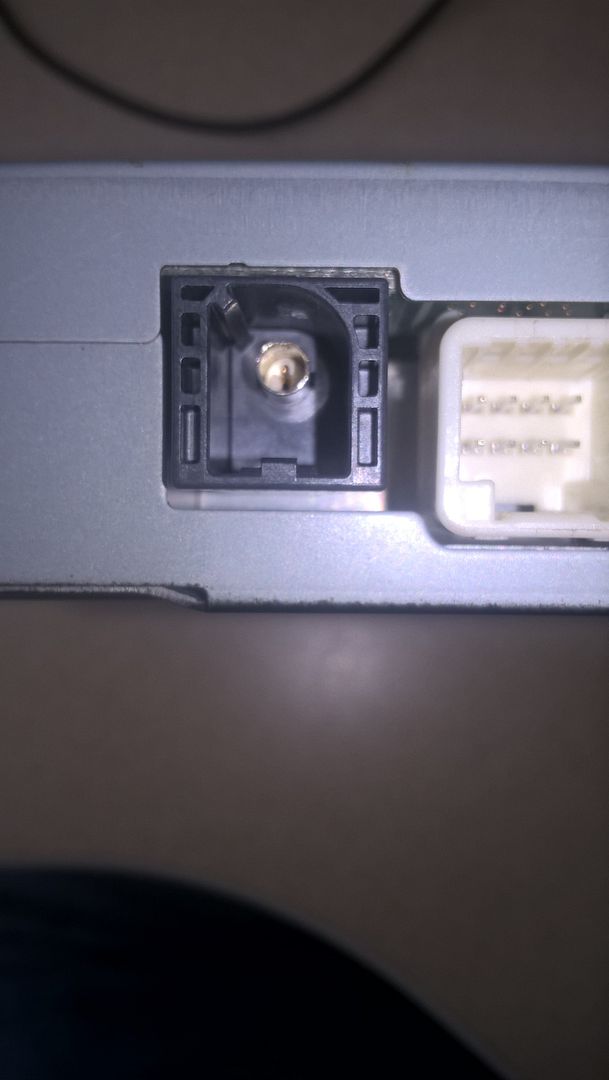

I used this antenna:
https://www.amazon.com/gp/product/B0009J6PYW/ref=oh_aui_detailpage_o01_s00?ie=UTF8&psc=1
This will be connected to the bottom box with black connector:
Next you will need to break a pink plastic part of a connector on antenna:
After the pink part is removed you will end-up with just metal part of the connecter which will be plugged directly into a black connector from picture 1. You can do the same thing with GPS antenna.

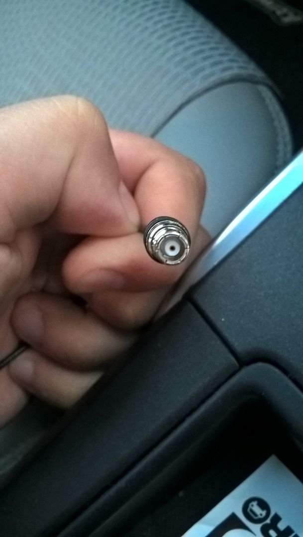

If you don't want to mess with GPS antenna connector then you can buy an adapter from Toyota:
Here is its connector.
#23 ·
The bottom image... which is the adapter... The part you are holding... does that go into the head unit, or is that where the GPS antenna plugs into?
I have an old XM Radio Antenna that has the pink FAKRA connector on it, so I can save a few $$ there.
I was hoping to be able to identify and obtain the actual connectors, and change them myself so they just plug in.... or come across the actual GPS antenna for the car...
