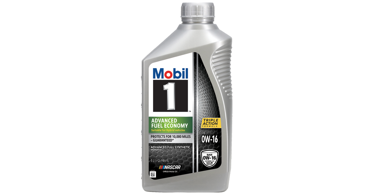

I know the Toyota filter and oil aren’t bad. I’ve always used Mobil 1. And so that means their filter, the M1-103A, and the only 0W-16 oil they have which is the advanced fuel economy.
Ultimately there’s little to no difference between any of the oils or filters from any of the reputable brands. I just say get 0w-16 instead of 20. It’s what the engine was made for. Unless you have the 1.8 in which case, I have no idea what it takes.
