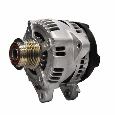

Maybe use a short segment of garden hose and see if OP can isolate the source of the noise. Check the alternator area maybe?
If it's the alternator then get a Denso rebuilt (densoaftermarket.com) or if you want to experiment with an Autozone Duralast reman with lifetime warranty (~$163). At least if it squeaks again you'll get another one free?
