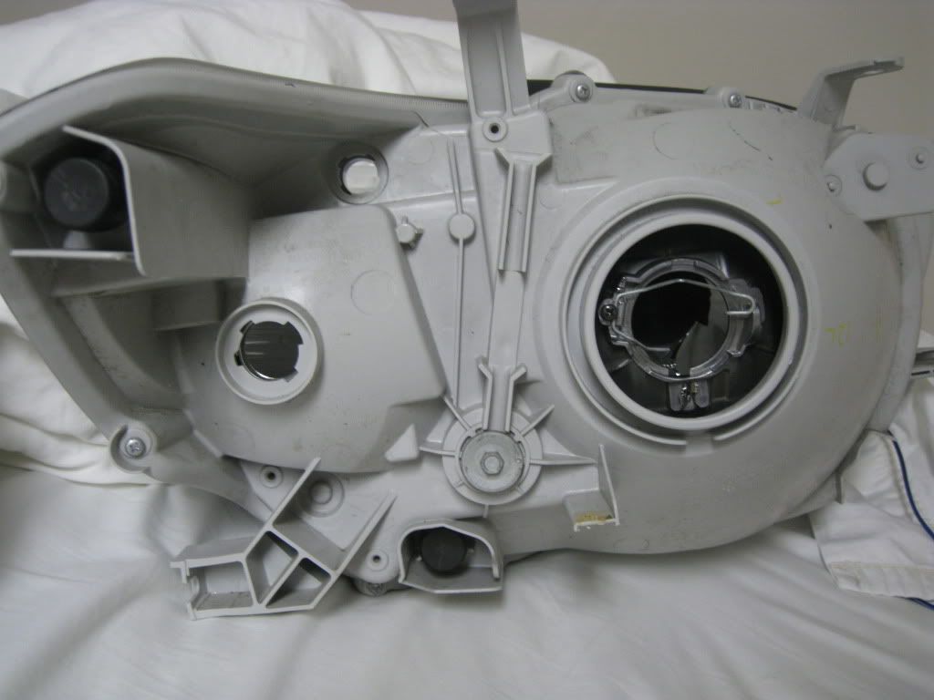

Headlights, and I presume taillights too, are not sealed completely. On the back of the Tacoma headlights, there are two holes with a foam filter in them to allow the headlight to breathe but not let dust/debris inside. Usually leaks are from around the butyl seal where the lens attaches (as sweeney posted).
Yup, nothing is truly sealed, almost all enclosures have air vents to maintain equal moisture to exterior air. On most Toyota headlights they are plastic caps (the black ones below) with foam on the inside that cover a hole to block stuff from entering but flow air.
Other times its as simple as a breathable tape/fine mesh over an opening. I know Ford uses that method on their earlier Explorers (Exploders)

#23 ·
Actually, I had to go look up the DIY to see what temp I used. It was 300 for 10-15 minutes. You turn the oven off once it reaches temps. After 10 mins, they weren't hot enough to separate. 15 mins did the trick. Plastic was not soft by any means.
