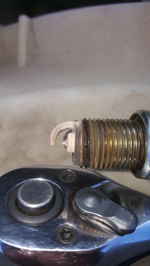

Your spark plugs show some oil burning. Switch to a high mileage oil (available in synthetic and synthetic blend) to condition your valve seals... Cleaning MAF/IAT sensor will help as well.
Spark plug ground electrode is well worn and rounded off at the tip, and your gap is now much larger than 1.1mm... http://densott.com/
Denso Iridium TT # 4701 http://www.rockauto.com/catalog/x,carcode,1434445,parttype,7212
After replacing the spark plugs, It seems to be doing better.
