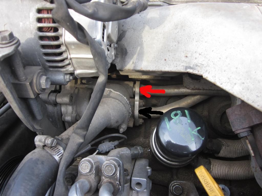

I think you are saying it is leaking from where one of these two arrows is pointing, right? I think you mean the one with the black arrow:

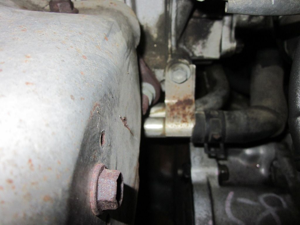

Here is a bracket (blue arrow) on this '99 Camry I4 through which the pipes are secured. You can see that the forward pipe is connected to a rubber hose. You can't see it in the photo, but the rear pipe does eventually connect to a hose as well. The pipes criss-cross as they go under the manifold, so the rear pipe is the one that connects to where the black arrow is and the front pipe to the red arrow. I believe if you loosen this bracket (green circles the bolt), you then have some flex thanks to the rubber hoses and can pull the pipe(s) out of the water pump:
Probably don't need it, but here's a closer view of the bracket with the pipes attached:

It's the bottom one marked with the black arrow.
