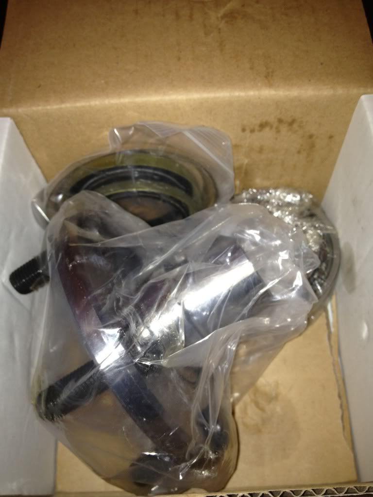

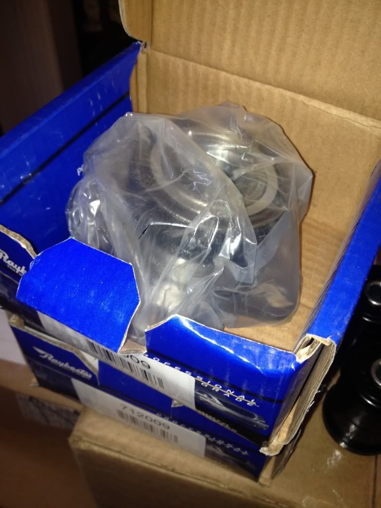

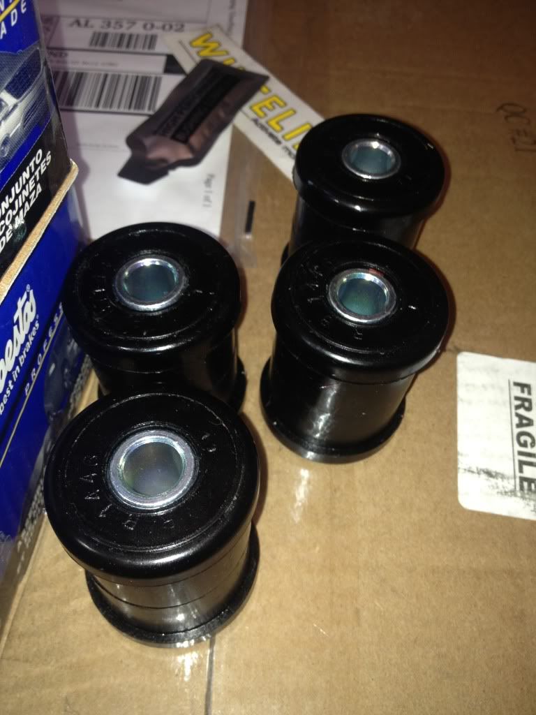

Well I got by rear bushings in a day late, of course there's only one set for I believe the bottom of the rear hub and the lower arm it attaches to.And received all four of my new wheel bearings.
