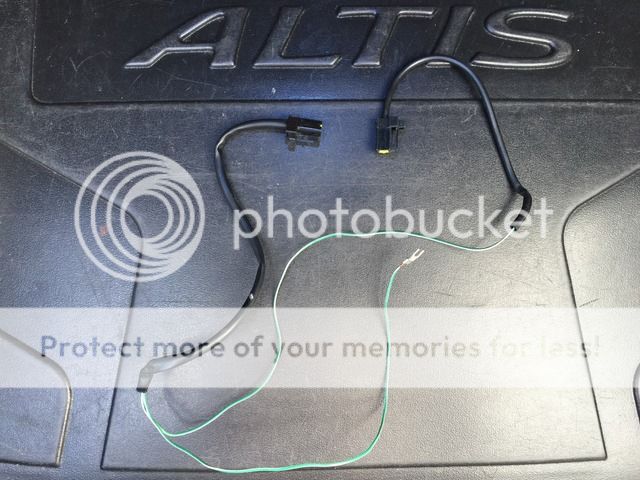

I didn't splice the wire, I used the existing Lexus wire. Put a spade terminal (ring terminal too) at the end and connect to the plug. Put a heat shrink tube and lots of electrical tape and that's it.
Toyota/Lexus with dual horns have the same wiring and plug so the horns are interchangeable. Left plug is where the split wire is.
I honk my horn for more than 2 minutes to test if it can handle the added horn and it did.
