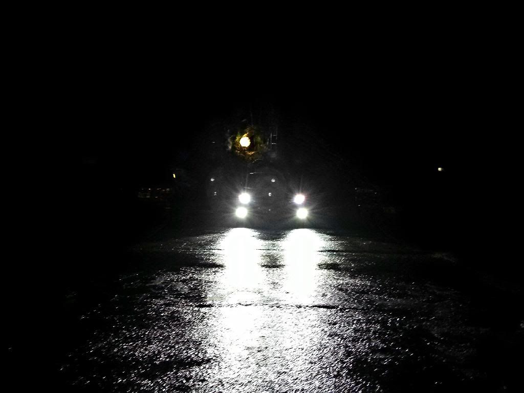

Here are more pics at night
What are you taking these pictures with? These look like 6000k plus from the pics, however the camera could be deceiving me. The only reason I am saying anything is that the first HID's I recently got for my 2012 SE flickered and were WAY too blue.

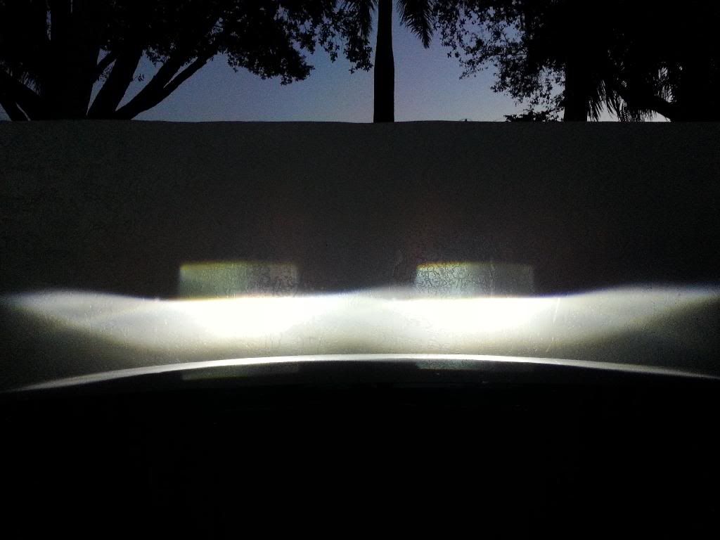

#40 ·
Yea with the second pic its obvious. You shot the pic from below the cutoff, so it should be equal glares I think. But your right, the drivers side is glaring much more. Looks like the passenger one is dimmer. Hope he fixes it. So thats good, it doesn't look to be alignment related.

#44 ·
Long story short I got lazy to take it in since it seemed to be a headlight adjusting issue. So I lowered both of my lights so it doesn't blind peoples side mirrors anymore however I didn't keep track how many clicks or w/e I went. Does my driver one seems slightly higher or no based on that pic. Lazy to do the 25 feet then with all the measuring and stuff, I'm just estimating. Had my friend drive my car last night & it didn't seem to blind anyone but the driver side seemed just slightly higher.
