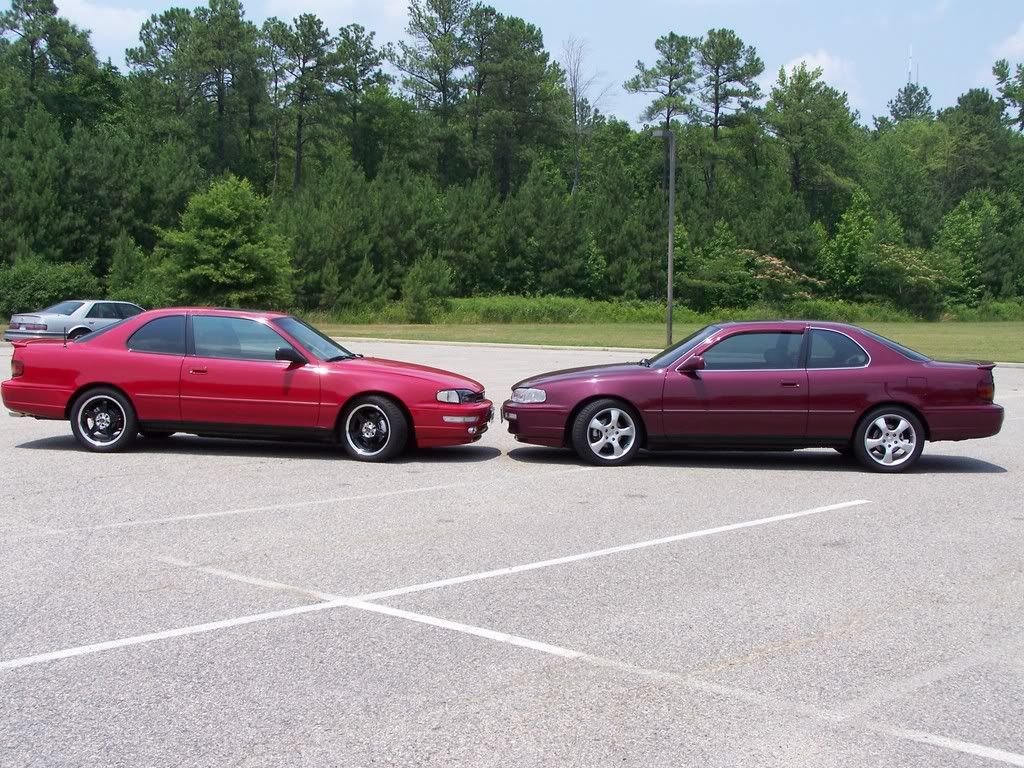

I use to have two Coupes! (sold the 94)
Both were dropped on H&R sports, also had TRD RSB's, 17" rims, 215/50 tires, and both 1mz engines.
The red 94 SE had Tokico's and the Ruby 96 LE has KYB GR2's. I preferred the Tokico over the KYB as far as the ride, they both handled great. If I ever need to replace the KYB's I'll buy Tokicos next time. Their just better IMHO :thumbsup:
I really doubt that the car will outlast the struts though.:lol:
