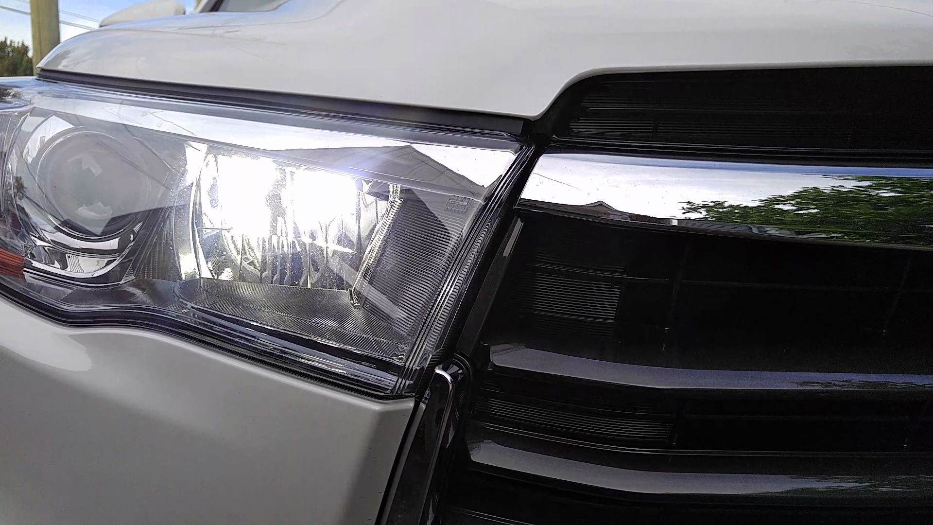

Here are some pic from this morning...
In the pictures they don't show much difference during the daytime.
DRL is on:
Here I turned on the low beam with the highbeam. See the HID low beam is still warming up showing a bit blue-ish.
Here are from the indoor parking:
With low-beam on:
With low-beam + high-beam:
I might need to make a video for the highbeam during day to show the difference of flashing...

In my quest to look for LED solution that can operate fully as a high beam but dim (and no flicker) as daytime running light on my HB/DRL combo headlight, I came across this post on the MTEC LEDs. Bought them on sale at ebay and finally got a chance to try them out. Results:
Pros:
- HB in full power while DRL is in reduced power
- No flicker in DRL mode
- Nice white color
- HB mode is bright (LEDs in 9 | 3 o'clock positions)
Cons:
- DRL is still pretty bright when you look at the lights head-on.
- This is my only concern that it is still too bright even though that the LED has reduced lumens in DRL mode... I emailed MTEC to see if there's a way to reduce the brightness further, but they said no.
Some pics attached. The 2 photos for the (a) DRL (LED) vs OEM halogen, and (b) HB (LED) vs OEM HB are taken with the same exposure setting on my phone to ensure the proper brightness comparision.
You can see HB is brighter than DRL. But DRL is still a tad too bright for my liking.
Anyways, I will keep them for now until I have a better solution.
