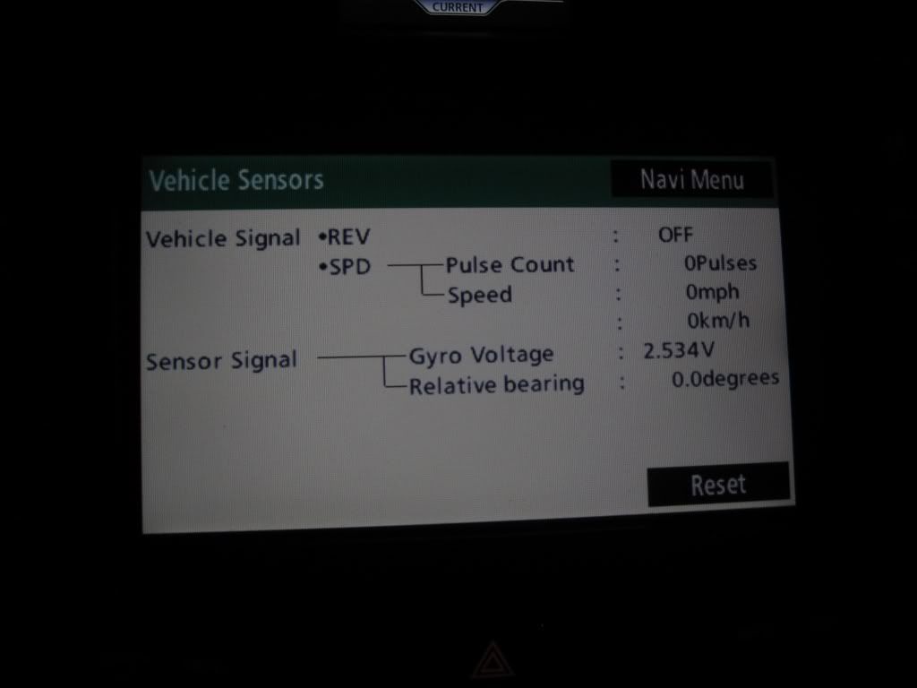

Here's a picture of one of the screens of the diagnostics menu. Is this supposed to be blank like this?
I didn't even to bother to see if the relay installed on the board already did that...I don't know why I didn't look at the relay before posting that above haha oops.
I remember having lots of readings (coordinates, etc...) from the antenna there from earlier today...

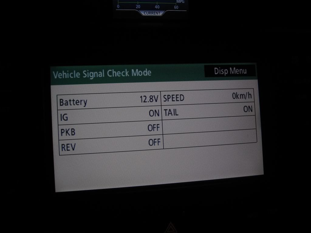

Ok here are a few screens from mine.
this one below is the built in error check
yep the 1 below is full of coordinate/degrees etc, something is definitly up with your system it looks like.
I thought the above was interesting. This is when my HL is running. I saw it say battery voltage was 12.8V, I kinda freaked out thinking my battery or alternator was shot, though using my multimeter i got 13.5V from the battery terminals.... I guess this is measuring voltage at the headunit and the OEM wires going from the alternator/fuse box to the headunit are so thin they are restricting the full voltage. Only explanation for that...
anyway, hope this helps DaMaDo

sweeny, thanks for those pics. Looks like you're tracking 9 satellites (the red numbers are the satellite IDs). I wonder why your GPS Information menu has navi menu on the right instead of the sensors check option like mine does. I have 10.1.
Here's what I've found so far. When I took everything apart and rebooted the system, the navigation worked perfectly. I got to my friend's house 20 miles away and all the turns etc worked out perfectly. However, the GPS Information screen was still blank. That doesn't make sense. This means my system might have always been like this and I would have never known.
