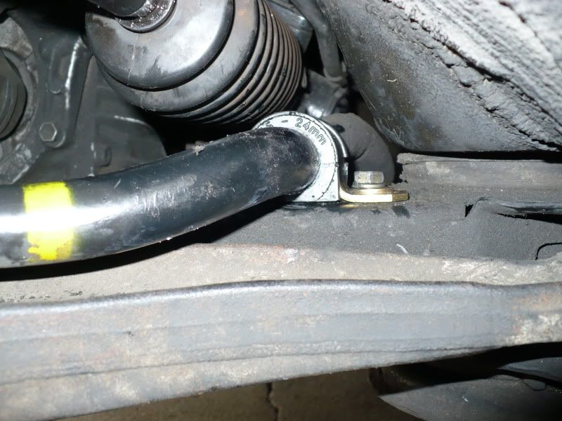

Here's what I have in my 96 4cyl.
These were a vast improvement over the old soft rubber bushings. Polyurethane bushings also gave a much more stable feel through the corners, because they don't compress/deflect as much, if at all, compared to rubber. Even new rubber bushing wouldn't perform as well as polyurethane. An added plus is that polyurethane will not degrade/deteriorate like rubber.
