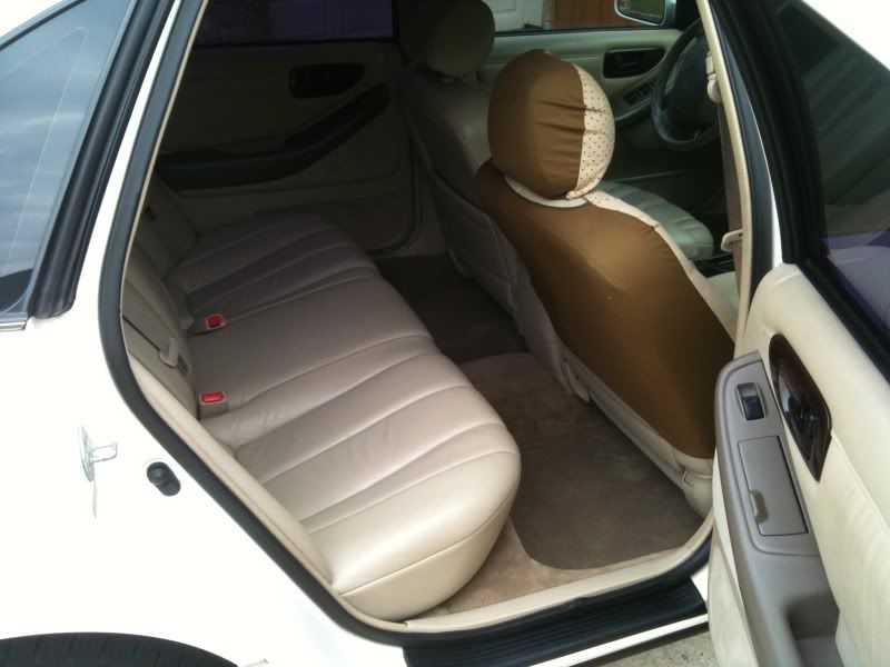

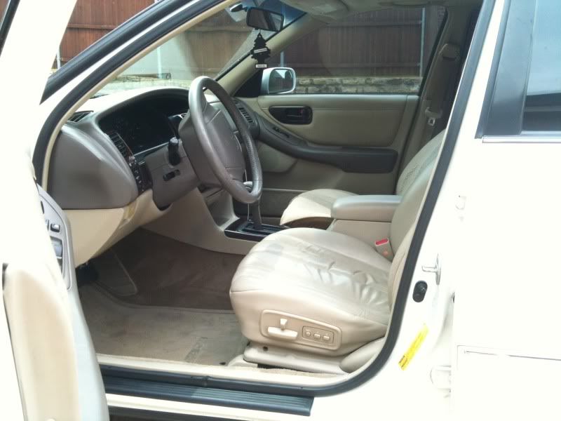

I followed the exterior with a quickie interior scrubbing, a thorough cleaning needs to happen but it will have to wait until more important projects are done. When I go at it later, I will be removing the front and rear seats so I can fully clean them along with the carpets.
