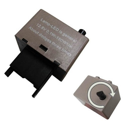

I just did a relay swap on my 2006 Solara about 10 minutes ago, Thanks to @gcrawdad 's schematic, I located the relay under the driver's side kick panel, it's the gray/tan box in the middle of the bunch of wires. Took a couple minutes trying to non-destructively remove the old relay, but finally got it with a screwdriver. I replaced it with an adjustable flash rate relay I found online just to have control over the signals. My hazard lights still function the same, and they still work without the key in the ignition. It made the "clicking" noise a little bit more noticeable when the signals are on which is nice. Hopefully the picture helps give a better "realistic" visual for anyone else doing this for LED signals.

Thanks a bunch. Having that screenshot is particularly helpful. I like the fact that the flash time adjustment is on top of that model so you can fine-tune once you have it installed.

8-Pin Flashing Speed Adjust Electronic LED Flasher Relay Fix
Web$12.99 USD SKU AA1186 Quantity Add to cart Features Description FAQ 1 piece 8-Pin, Part # 81980-50030, 81980-53010, 81980-02030, 81980-34020, 066500-4650 Produce no …
