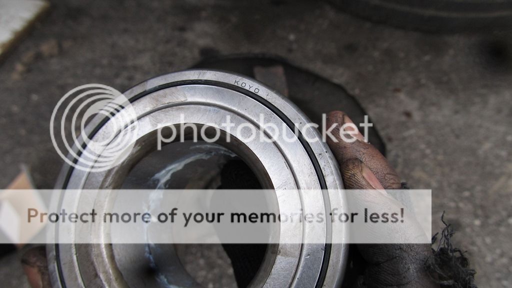

As for where to buy, check eBay and Rockauto. I found an OEM Koyo bearing on eBay for super cheap when I did my 2009 Camry bearing.

I think I got my Koyo bearing few months back from NAPA locally. I think it still sitting in my drawer waiting to be installed and was 10 more than I could have gotten online.
